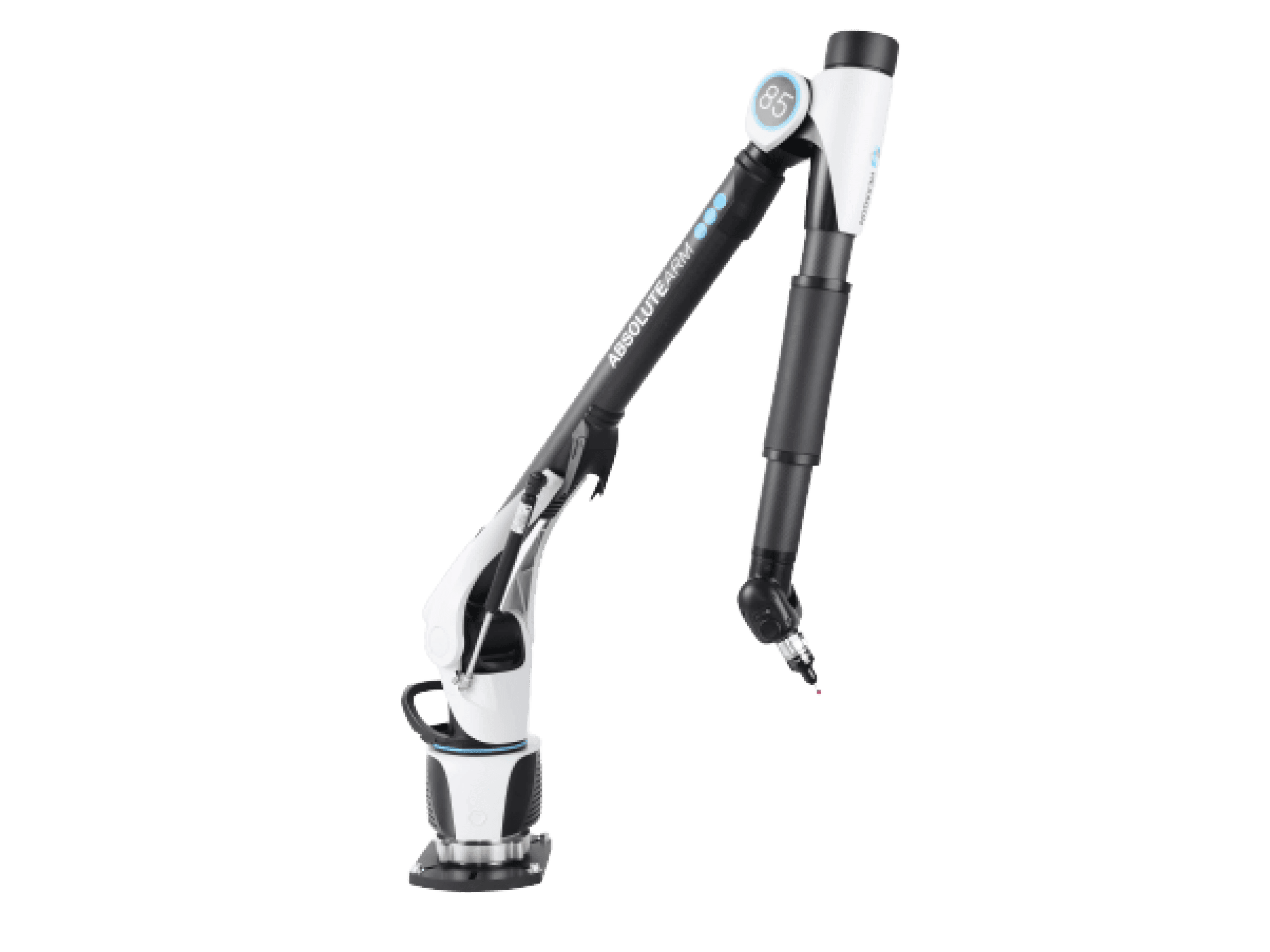

A robust, portable measuring arm with smooth set-up and repositioning
A specialised touch measurement tool that also boasts the option for entry-level 3D scanning – the Absolute Arm 6-Axis is one of a kind. Based on patented technology with Absolute Encoders located at every articulation point and designed with ease-of-movement and usage as a focus, this is a portable measuring arm like no other.
IP54 certification
The world’s first portable measuring arm with an IP54 rating, and guaranteed functionality in temperatures of up to 45 degrees Celsius, the Absolute Arm is the perfect partner for measurement in even the most challenging environmental conditions.
Absolute portability
Setup and repositioning is a quick and easy process, while the functionally designed and shock-resistant carry case keeps everything secure during transport.
Advanced materials
Built on a foundation of high-tech carbon-fibre tube construction, the Absolute Arm maintains strength and thermal stability under any environmental conditions, offering reliable accuracy whatever the environment.
