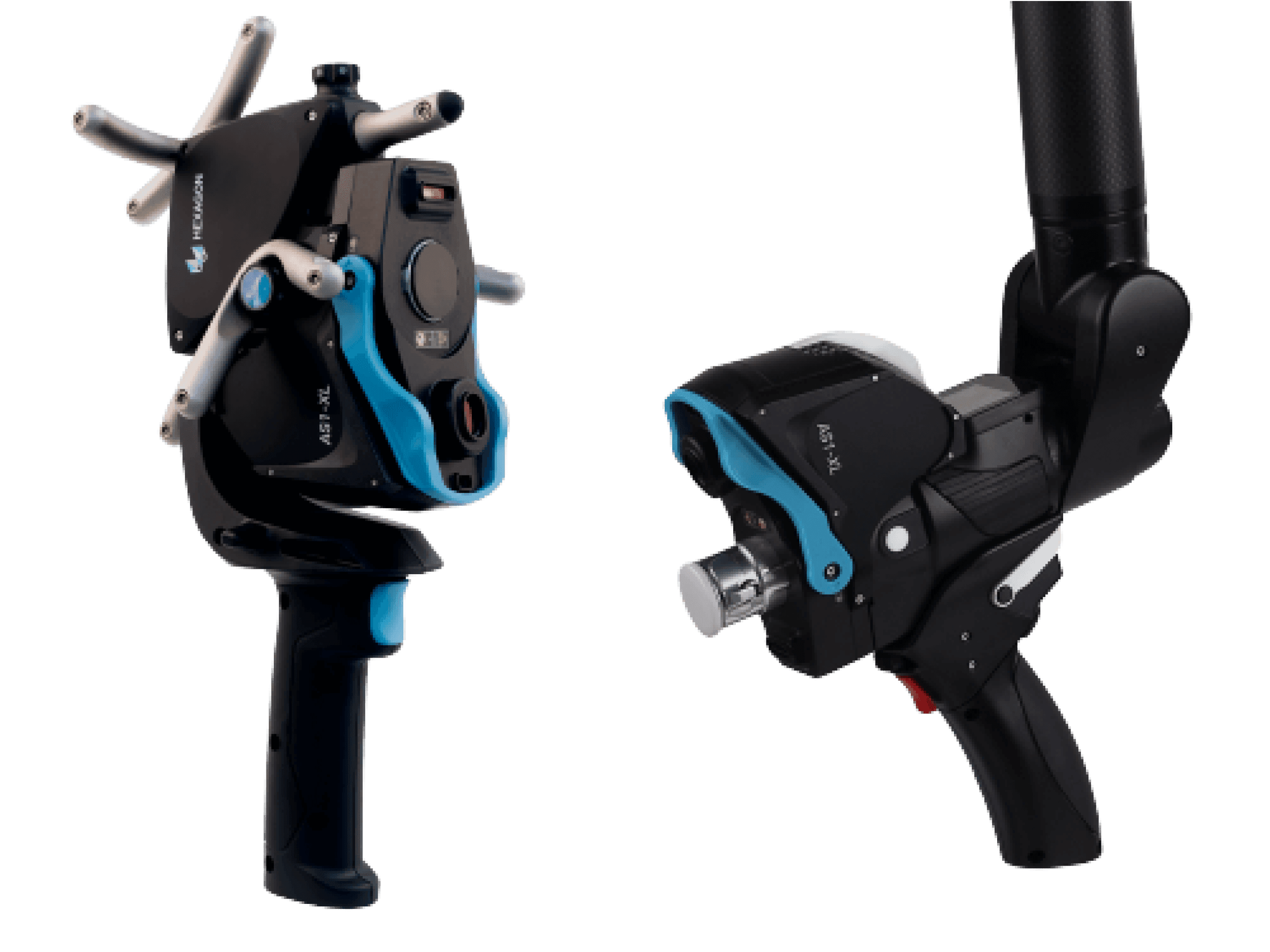

Fast and simple large-surface inspection
The Absolute Scanner AS1-XL is a 3D laser scanner designed to meet the needs of emerging 3D scanning applications for which higher productivity is the priority. Working in conjunction with both our Leica Absolute Tracker AT960 laser tracker systems and our Absolute Arm 7-Axis portable measuring arms, the AS1-XL opens the door to previously infeasible large-scale 3D digitisation tasks.
Extra-wide scan line
Never-before-seen measurement scan-line width of up-to 800 millimetres makes the full digitisation of large surfaces faster and easier than ever before.
Large standoff
Unprecedented measurement stand-off of up-to 1000 millimetres delivers excellent access to hard-to-reach hidden measurement areas, opening up a new world of laser scanner applications that were previously out of reach.
SHINE performance
Advanced algorithms of our SHINE technology allow you to digitise almost any surface type with the default exposure settings, from glossy black plastic automotive body parts to moulded carbon-fibre components, making high-quality measurement easier than ever with no high-level training required and operator variability eliminated.
Absolute Scanner AS1-XL Specifications
| Scanner accuracy | |
0.134mm₁ | |
| Max. point acquisition | |
Up-to 1.2 millions points/sec | |
| Min. point spacing | |
0.080 mm | |
| Scanning frequency | |
Max. 300 Hz | |
| Laser line width | |
600 mm (at mid-field) | |
| Stand-off | |
700 +/- 300 mm | |
IP 54 | |
| Automated exposure | |
SHINE |
₁PFORM.Sph.1×25:ODS, based on a part of the ISO-10360 standard
