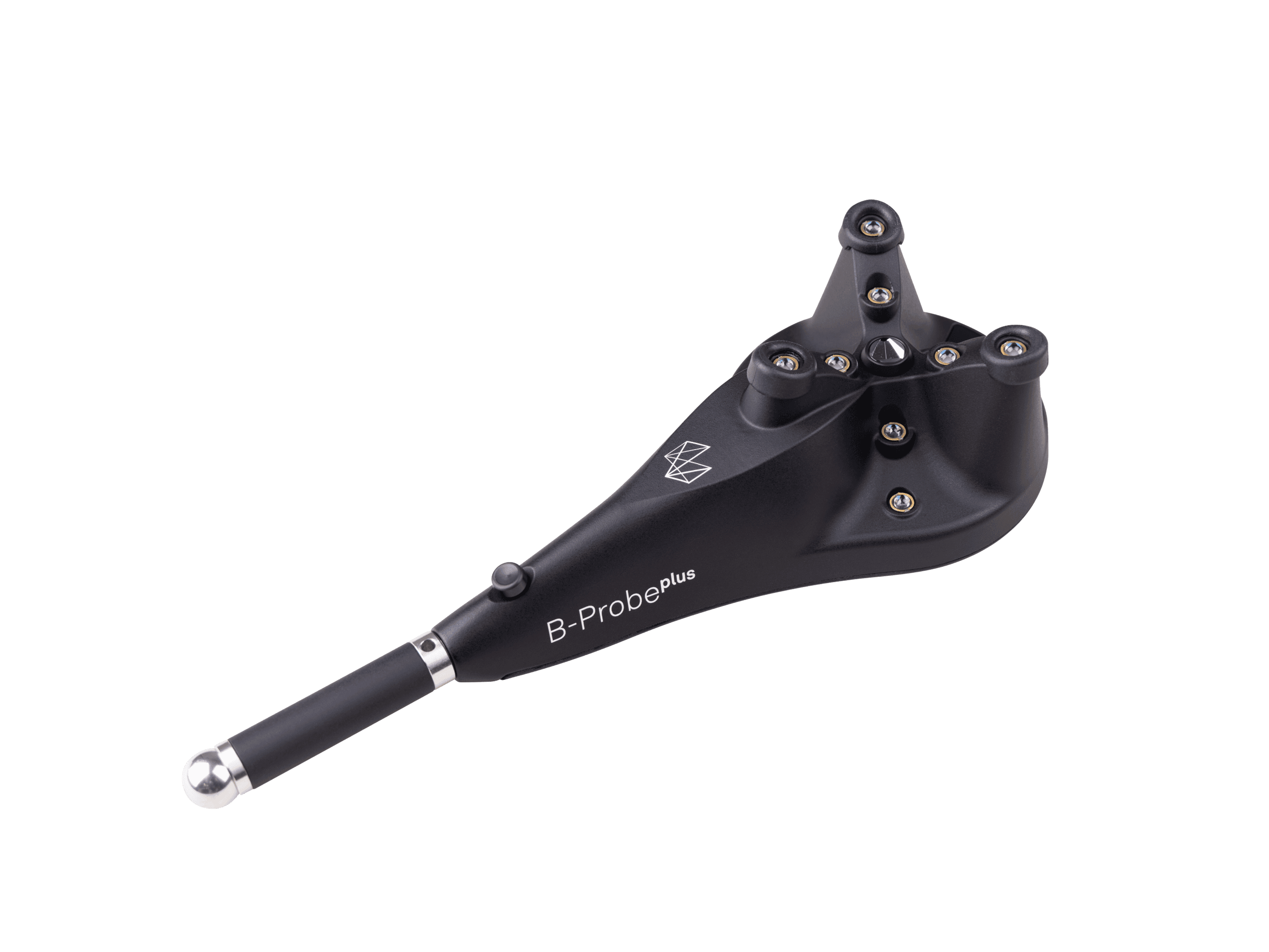

Ultra-portable, ultra-usable entry-level probing
The B-Probe plus is a dedicated handheld probing tool designed for the Leica Absolute Tracker AT500. Able to gather hidden 3D points across a large measurement volume, the B-Probe plus is a completely wireless solution that makes probing measurement easy to perform and affordable.
B-Probe plus Specifications
| Size and weight | |
230 x 80 x 54 mm | 0.14 kg | |
| Accuracy₁ | |
+/- 100 μm | |
| Measurement range | |
1.6 to 12 m | |
| Continuous mode | |
Build mode | |
| Cable-free operation | |
| Acceptance angle | |
+/- 16° | |
| Automatic stylus recognition | |
Fastening type | |
| Multiple programmable buttons | |
Not supported |
₁ Probing size, according to ISO 10360-10 - measured at 2 m.
