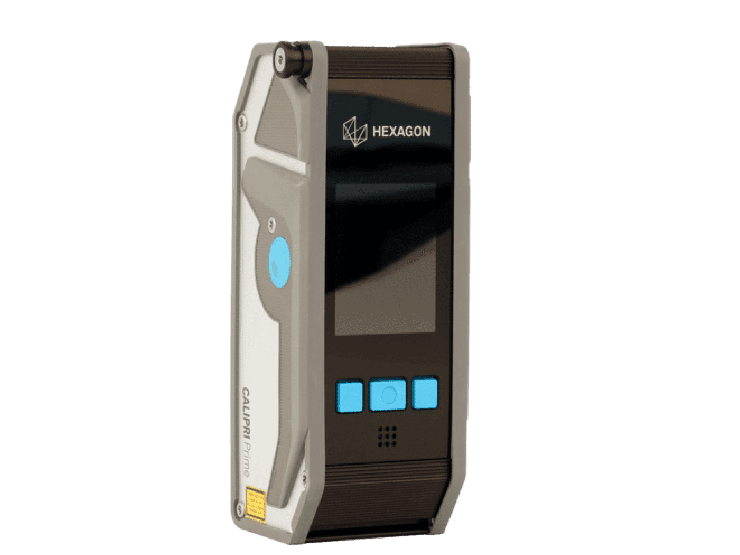

Handheld optical inspection solution
With CALIPRI Prime, errors caused when attaching bulky instruments and variations from using wheel profile wear gauges or templates are a thing of the past. The device’s embedded software evaluates flange height, thickness, and cross-dimension (qR) according to preset limit values. All the wheel characteristics are displayed on the sensor screen within a few seconds and are available for digital transfer to your PC if needed.
The CALIPRI Prime is typically used in for train wheel measurement in maintenance applications in service shops, stations, or in the field. It can replace mechanical gauges and fixtures for several wheel measurement applications, reducing the total cost and improving accuracy.
CALIPRI PRIME Specifications
| Measurement capability | |
Train wheel profiles | |
| Technology | |
Non-contact laser light section with patented CALIPRI principle | |
| Laser class | |
2M | |
IP54 (ruggedized design) | |
| Operation | |
Manual, battery supplied | |
| Field of view | |
150 – 130mm | 6 x 5 inches | |
Accuracy < +/- 80μm Repeatability < +/-35µm | |
| Data export | |
csv, pdf |
