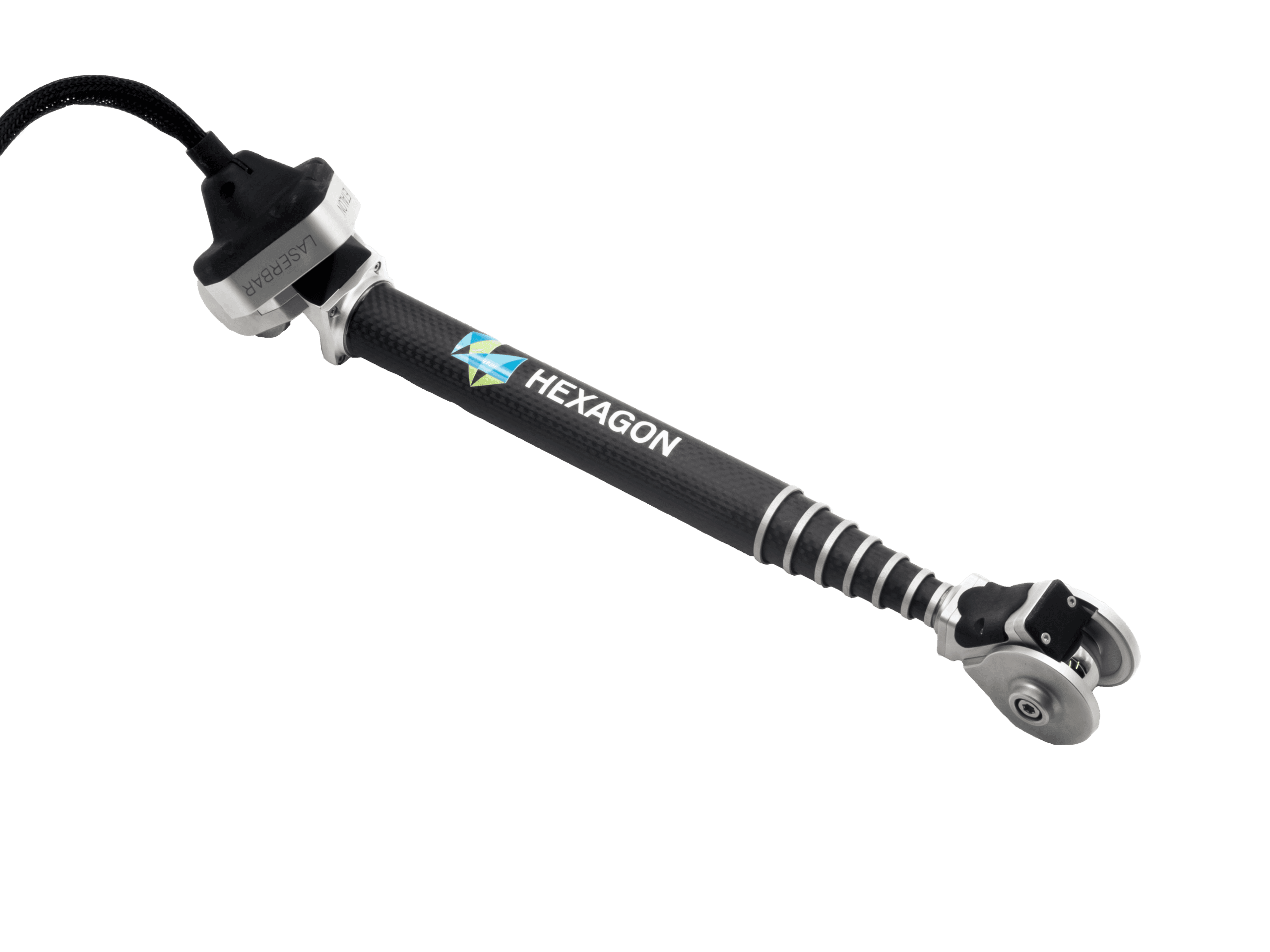

Greatly reduces the complexity of machine tool calibration and volumetric error compensation
The ETALON X-AX LASERBAR replaces the need for multiple devices when calibrating small and medium 3- to 5-axis machine tools. Instead, it provides a single, semi-automatic system that rapidly delivers results at the touch of a button. It is a compact, light, and cost-effective solution that uses patented measurement technologies to determine volumetric machine deviations.
ETALON X-AX LASERBAR Specifications
| Measurement uncertainty | |
1 μm | |
| Measurement range | |
270 – 1050 mm (Telescope L) 210 – 730 mm (Telescope S) | |
| Typical machine size | |
0.5 – 1.5 m | |
| Verification standard | |
ISO 230-1, 230-2, 230-4, 230-6, 16907 | VDI 3441 | ASME B5.54 |
