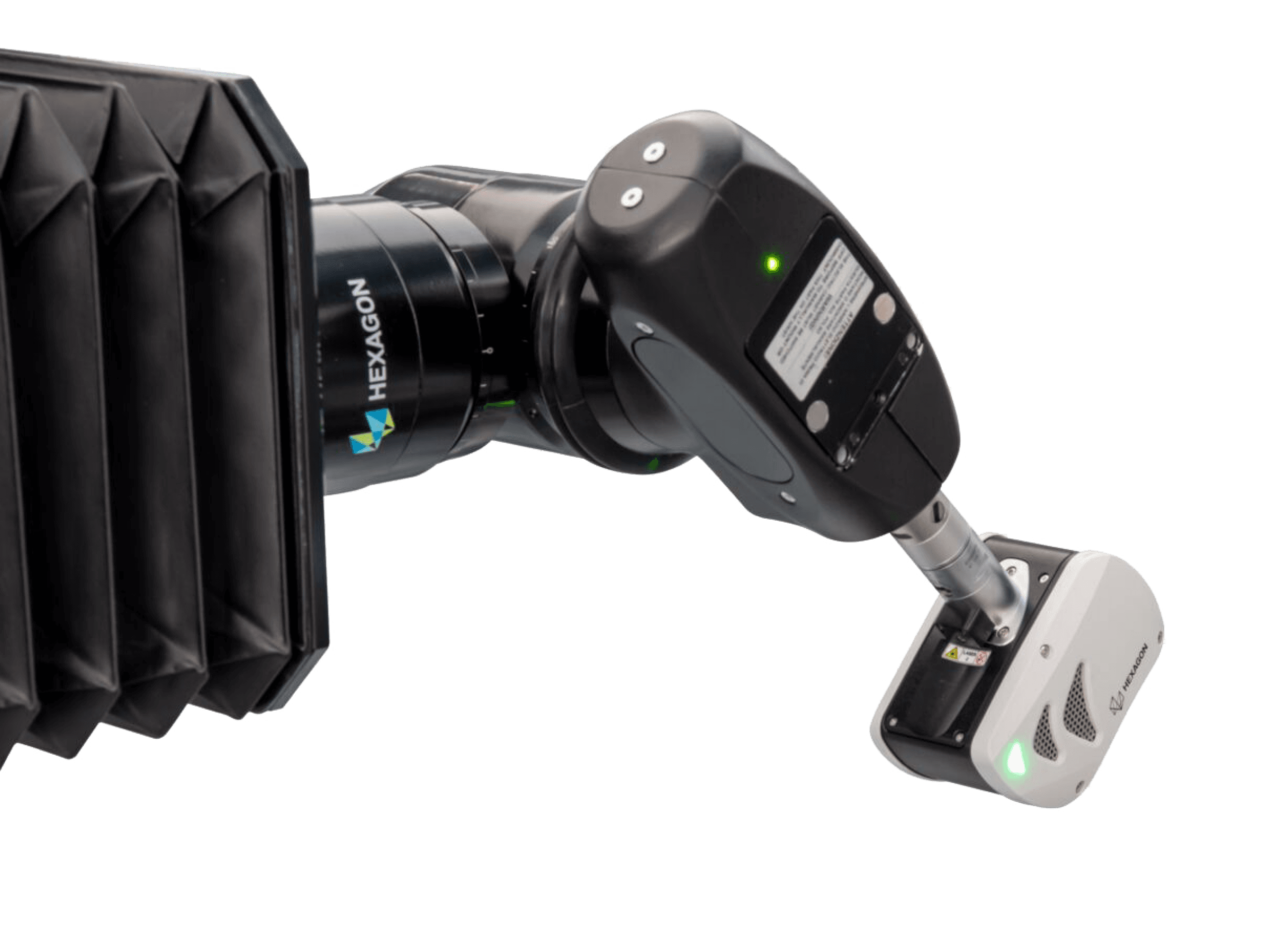

Continuous wrist for measurement at any angle
The HH-ACW-43MW continuous wrist is a heavy-duty precision mechanism able to quickly orient the probe to any attitude following precise 3D trajectories.
Its ability to orient the probe as needed in space (virtually infinite angular positions) and the possibility to handle exceptionally long probe extensions allow full access to the measured part. The HH-ACW-43MW is also available in the configuration with an integrated 3rd continuous axis developed for the optimized use of non-contact sensors.
