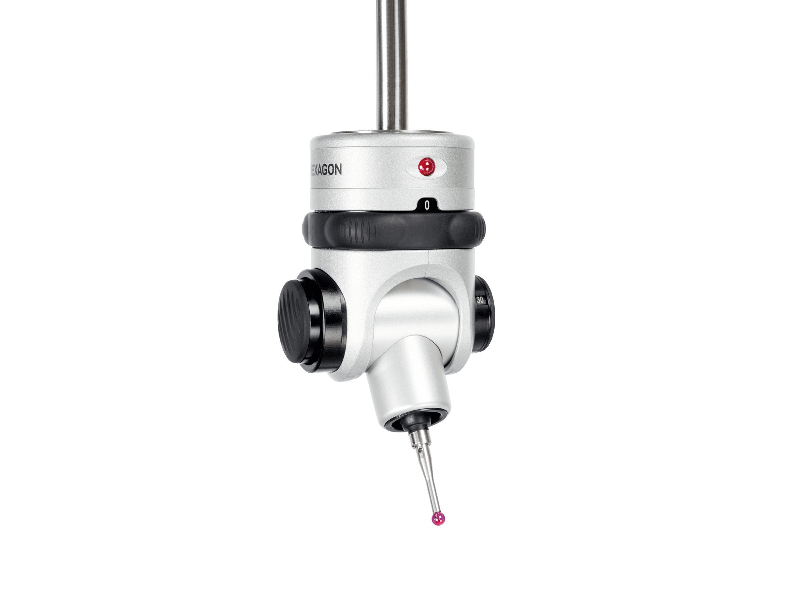

A probe head with an accurate indexing probe stylus
The HH-MI can turn to 168 positions and swivel in 15° increments without the need for recalibration.
The angular movements A and B are clearly indicated in separate windows on the probe head so that the precise angle can be viewed at a glance. HH-MI can be disengaged by hand. Tactile and visual feedback lets the user know the angular position of the ball probe at all times.
HH-MI Manual Probe Head Specifications
| Indexing angle | |
15° | |
| A-axis angle | |
0° - 90° | |
| B-axis angle | |
+/-180° | |
| Total number of positions | |
168 | |
| Rotation speed | |
Manual, by two buttons on the probes head | |
| Max. extension length | |
Not available | |
| Probe mounting | |
Not available | |
| Changer rack compatibility | |
Not compatible |
