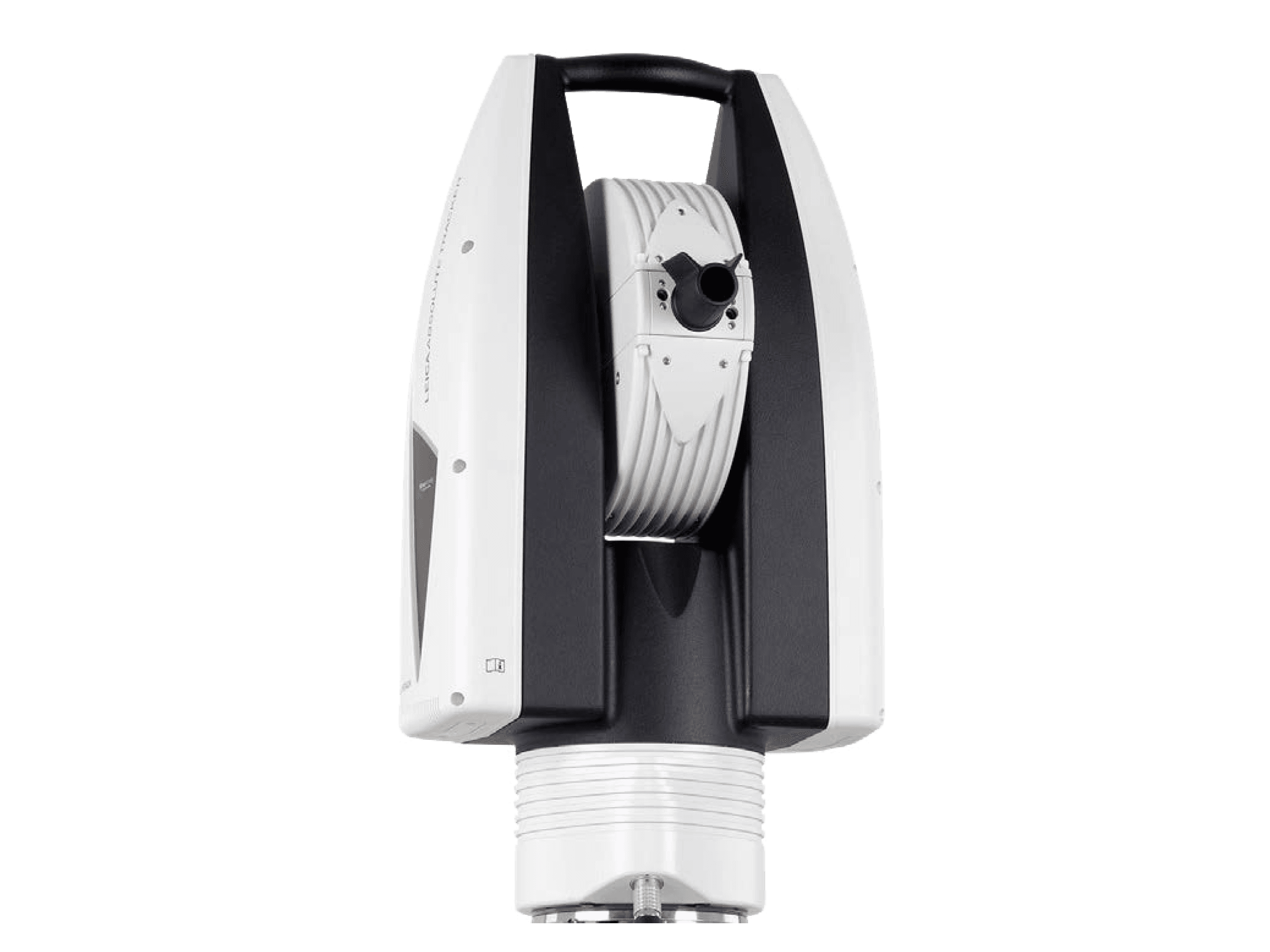

3D portable laser tracker with high-speed dynamics as standard
The Leica Absolute Tracker AT930 is the next generation 3D laser tracker to feature the Leica Absolute Interferometer (AIFM), giving high-speed dynamic measurement capabilities that set it apart from the competition. With automatic target location, real-time architecture and the ability to instantly re-establish an interrupted beam, it is the fast, accurate and user-friendly way to measure to reflectors.
All-in-one design
The AT930 requires minimal setup and operator training, and can be ready to measure straight from the box.
Absolute interferometer (AIFM)
The AIFM single distancing unit combines the accuracy of an absolute distance meter and the speed of an interferometer to give readings quickly and accurately with no need for a home point.
1 kHz data output
Real-time architecture with dynamic performance gives a measurement rate of up to 1 000 points per second, enabling more detailed data capture, more quickly.
Leica Absolute Tracker AT930 Specifications
+/-15 μm + 6 μm/m | |
| Measurement range | |
Up-to 80 m | |
| Measurement mode | |
Stationary, Continuous (Reflector) | |
| Operating temperature | |
0°C to +40°C | |
| Data output | |
1000 Hz | |
IP 54 | |
| Tracker size and weight | |
258 x 238 x 477 mm | 14.2 kg | |
| Certification | |
According to ISO 10360-10 |
