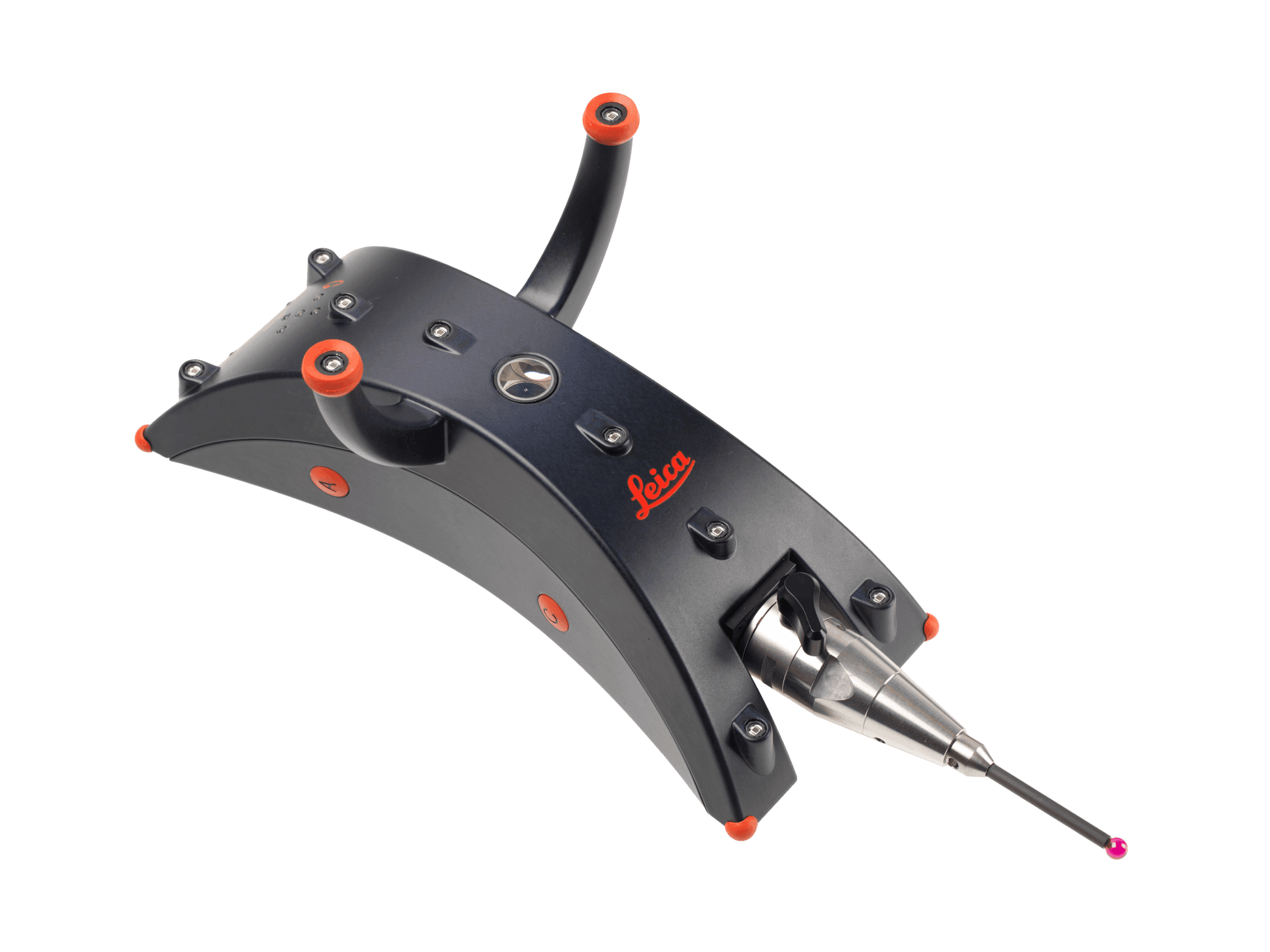

The Walk-Around CMM
Leica T-Probe, the "Walk-Around" armless wireless device for probing of hidden, hard-to-reach points and measuring of up to 9 cars in one setup with minimal setup times, sets new standards by increasing accuracy, offering a ten-fold increase in point acquisition rate and providing user-assignable multi-function buttons.
The Walk-Around CMM
Leica T-Probe Specifications
| Size and weight | |
310 x 129 x 70 mm | 0.65 kg | |
| Accuracy₁ | |
+/- 50 μm | |
| Measurement range | |
From 1.2 to 30 m | |
| Continuous mode | |
| Cable-free operation | |
| Acceptance angle | |
+/- 45° | |
| Automatic stylus recognition | |
| Multiple programmable buttons | |
YES (4 buttons) |
₁ Probing size, according to ISO 10360-10 - measured at 2 m.
