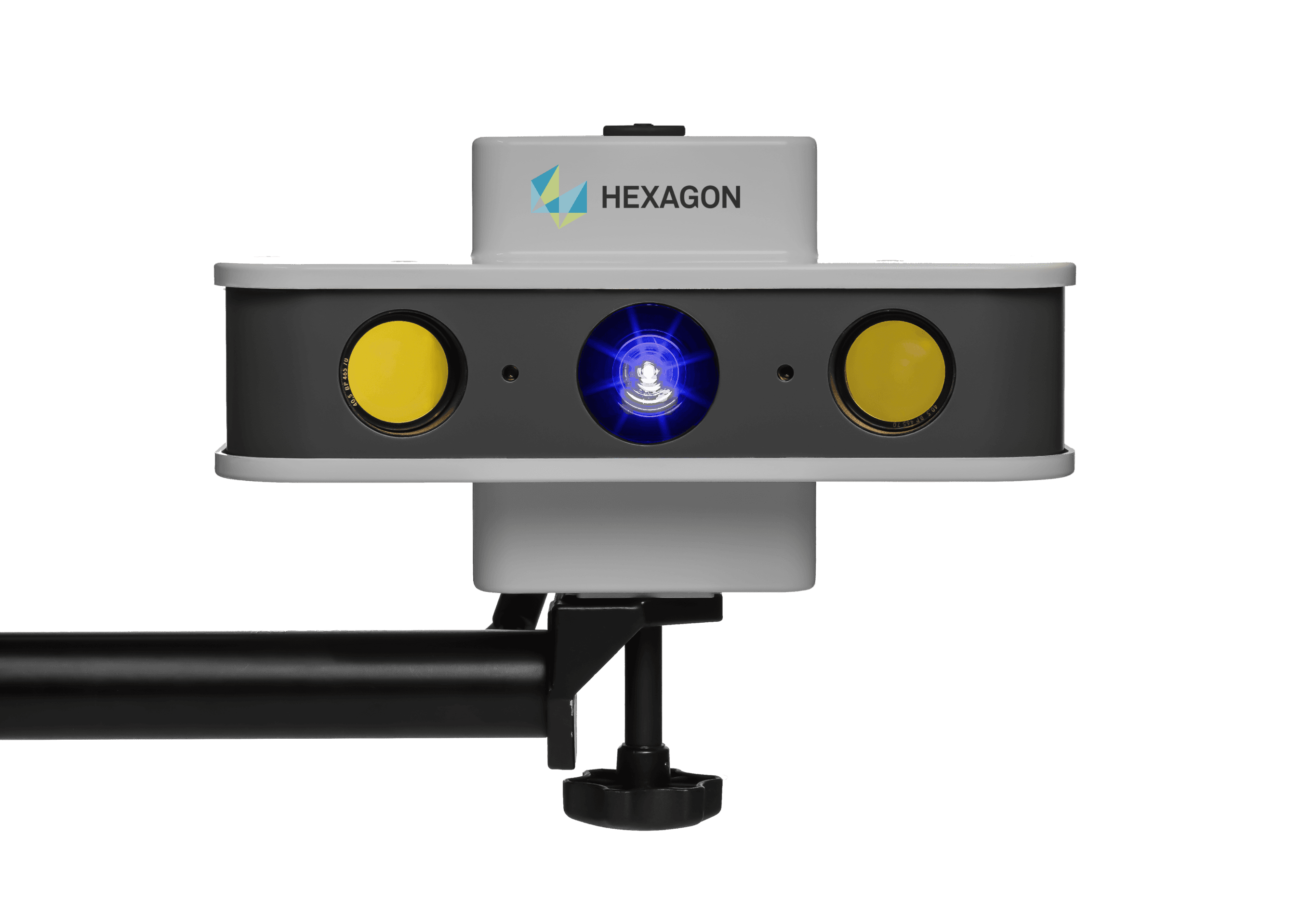

Simple and precise optical 3D scanning
The PrimeScan optical 3D scanner line from Hexagon is an attractive entry-level solution for highly precise 3D digitisation of industrial components. Like other Hexagon structured light scanner models, the PrimeScan is based on fringe projection technology that provides the strongest luminous power and highest projection quality.
PRIMEScan Specifications
| Camera sensor | |
Monochrome, CMOS, 2/3” Monochrome, CCD 1” | |
| Camera resolution | |
5.0 MP | 2448 x 2078 8.0 MP | 3264 x 2448 | |
| Projection unit | |
Miniaturized projection technique | |
| Min. measuring time | |
1 sec. | |
| Sensor weight | |
3.8 kg | |
| Control unit | |
Integrated, USB 3.0 | |
| Accuracy₁ | |
From 4 μm (PrimeScan R5) From 6 μm (PrimeScan R8) |
₁ Sphere spacing error.
