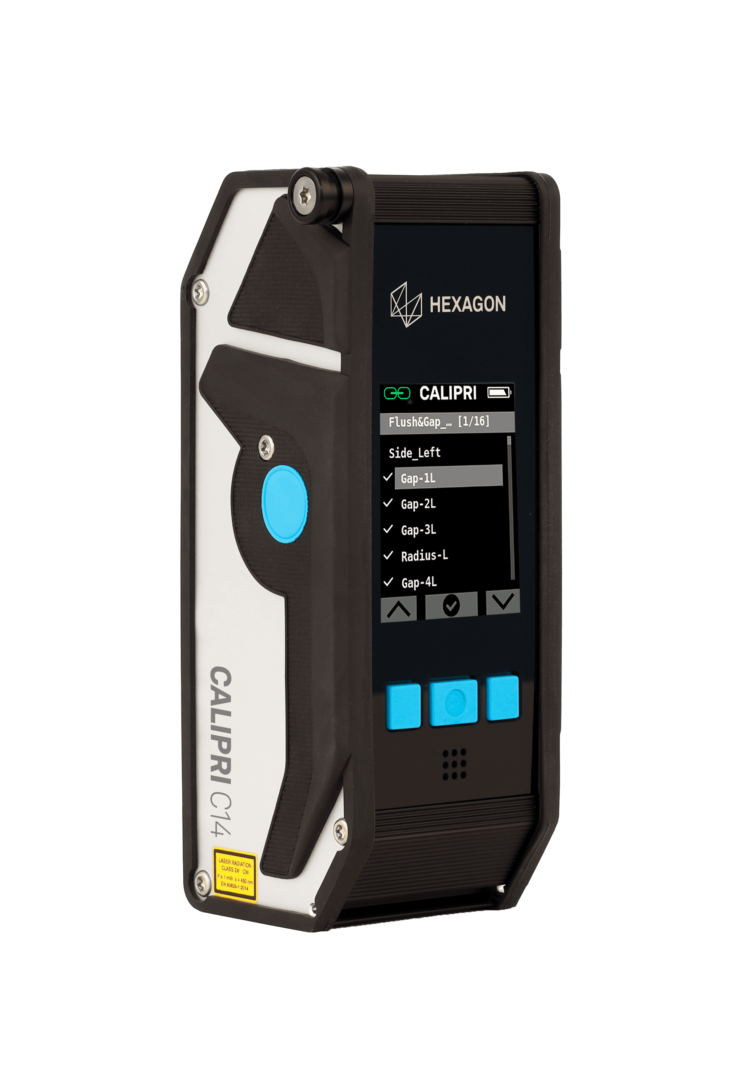

Highly accurate gap measurement
The handy CALIPRI C14 measuring system can inspect even highly complex profile shapes in a matter of seconds with its characteristic swivel movement. Numerous inspection methods allow individual evaluation of gaps, folded edges and design lines.
Highest reliability
Capture any gap contour (small, large, hidden, concealed, seal, 0-gap) with the highest repeatability.
360° feedback
Audio, haptic and visual feedback allows easy operator use. Capture progress is displayed on the device screen.
Immediate results
After the measurement, results are shown as measured values on the sensor and as a profile curve on the connected tablet (PC). Any deviations from the target values are highlighted in colour.
CALIPRI C14 Specifications
| Measurement capability | |
Flush & gap - Manual measurement, off-line measurement | |
| Technology | |
Non-contact laser light section with patented CALIPRI principle | |
| Laser class | |
2M | |
IP 54 | |
| Operation | |
Portable, wireless, battery powered | |
| Gap size range | |
50 x 50 mm | |
| Accuracy & repeatability | |
Accuracy < +/- 30μm, Repeatability < +/-15µm | |
| Data export | |
csv, xml, pdf, customer specific |
