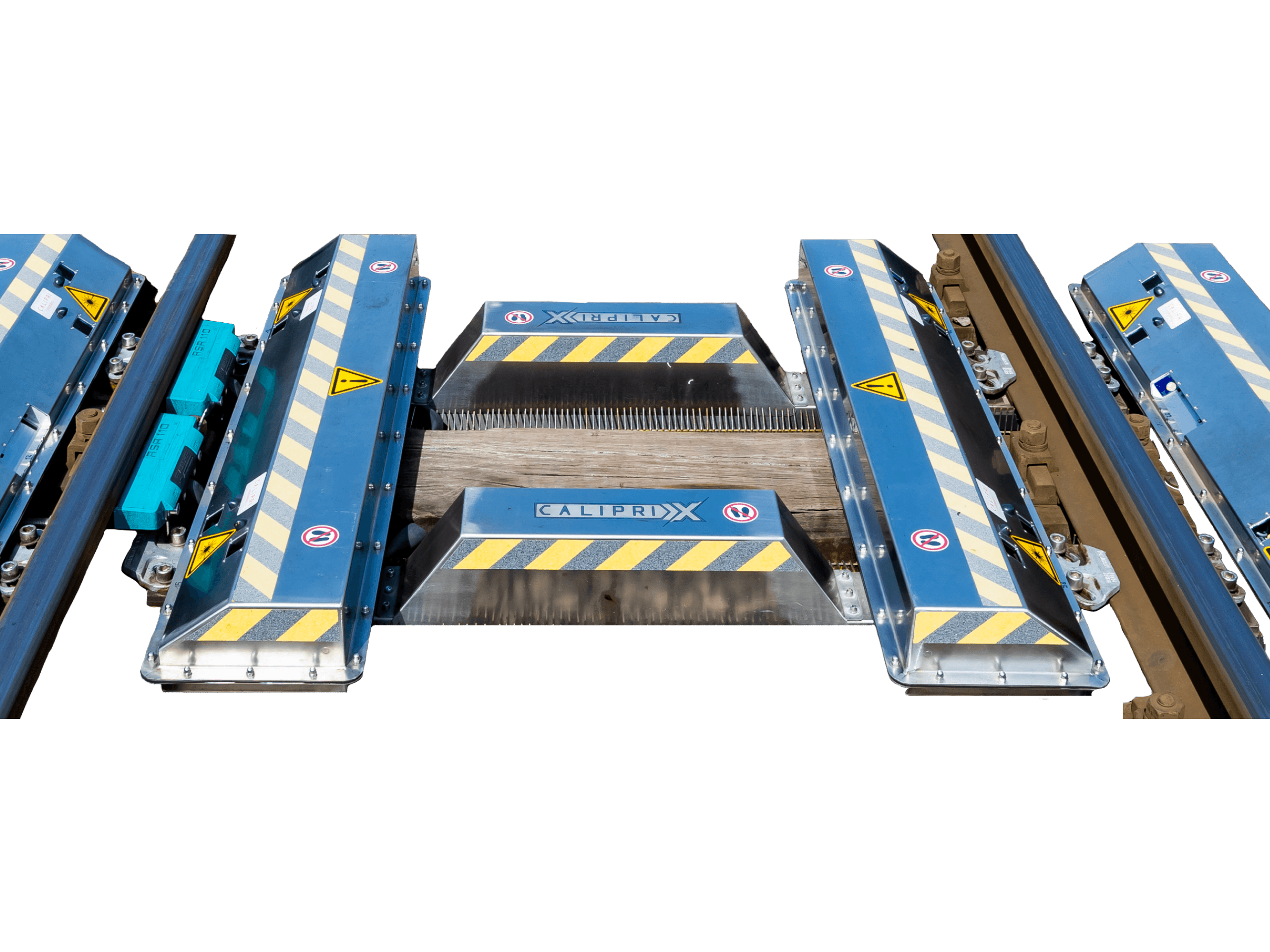

Automated on-track measurement of wheelsets for the rail industry
CALIPRI X eliminates time-consuming and costly manual measurement, delivering precise results in seconds, and immediately identifying out-of-tolerance areas.
An accurate understanding of wheel wear condition allows you to move from interval-based to condition-based maintenance – and ultimately true predictive maintenance – enabling better resource planning and significant cost savings. The non-contact optical laser system measures all wheelset parameters according to the European standard EN 15313 – including wheel profile, diameter, back-to-back distance, equivalent conicity, camber and wheel toe.
CALIPRI X Specifications
| Measurement capability | |
Train wheel profile, wheel gauge measurement | |
| Technology | |
Non-contact laser light section with patented CALIPRI principle | |
| Laser class | |
3B | |
| Operation | |
On-track installed, automated system | |
| Track gauge | |
1435mm | |
| Wheel diameter | |
660 – 1260mm | |
Wheel flange parameters +/- 0.1m | |
| Data export | |
xml, automated, CALIPRI predictor enabled |
