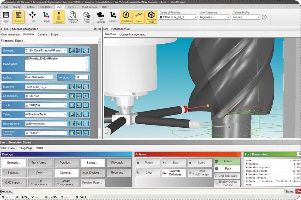

The I++ Simulator can be used to simulate existing measurement programs, as well as creating new ones using teach-in or offline methods such as CAD, all without machine downtime.
The benefits of using I ++ Simulator include:
Offline programming with the digital twin using the I++ DME standard
Optimise quality, drive productivity

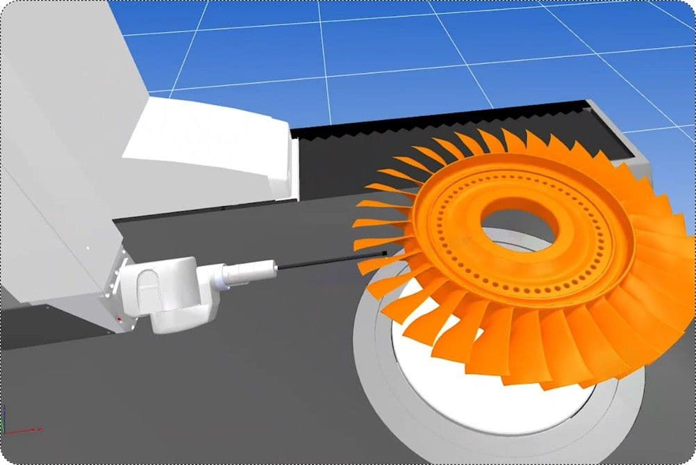

I++ Simulator enables you to simulate measurement programs (such as QUINDOS) and test new applications, with complete visualisation of the coordinate measuring machine (CMM), sensors, fixtures, parts, loading systems, and more.
Reduce machine downtime
Keep your CMMs free for inspection. The digital part is measured virtually. A comparison with the CAD model or the conventional nominal data provided in your analysis software gives real results including deviations.
Use of the I++ DME standard
The simulator is based on the neutral measuring device interface I++ DME. In this sense, it functions as an I++ server and measuring device in separate software. It can be controlled with any I++-compliant measuring software (I++ client).

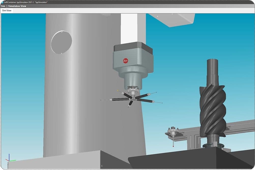

The I++Simulator has a comprehensive library of components from various manufacturers. If your component is not listed, or if it is a custom design, you can easily build the required component using the I++Simulator's built-in designer (such as multiple probe holders, joints, and more, up to tool changer racks and rotary tables). It is also possible to define them based on given CAD data. Detailed instructions can be found in the manual of the I++Simulator, which you can call from the menu item 'Help'.
You can import CAD files in IGP, STL, 3DS, WRL/X3D formats directly into I++Simulator for parts or components. The conversion into the specific IGP format is done internally automatically by the I++Simulator. If you work with QUINDOS, you can generate the IGP format directly from the loaded 3D-CAD model (IGES, STEP (STEP AP 203, AP 214) or native CAD format) with the command CadConvertIgp. Detailed information about the command can be found in the integrated QUINDOS help.
