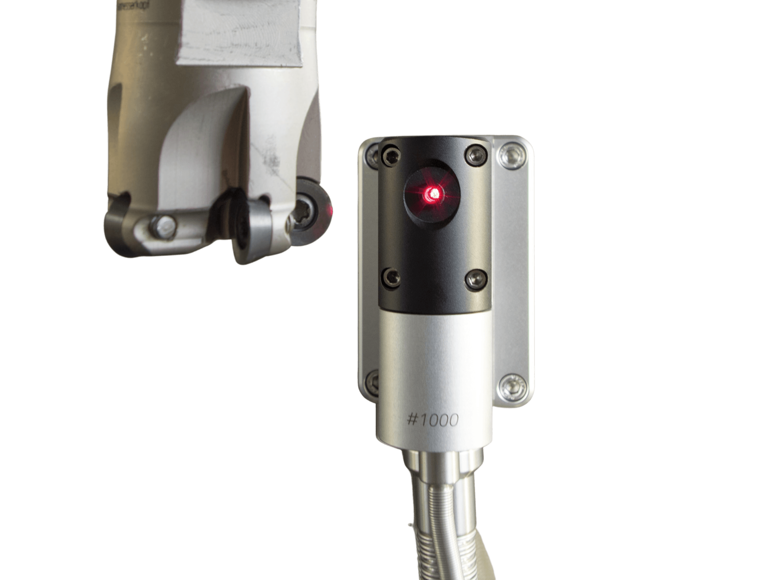

The laser tool measurement system LTS35.66 is characterized by the greatest degree of flexibility during installation and a simple commissioning procedure. Different assembly aids support integration into the most varied types of machines. This compact, robust system is absolutely immersion-proof in accordance with IP68.
Whether in the machining area or the tool magazine, the pneumatic shutter unit reliably protects the optics against dirt, thereby minimizing maintenance. An air curtain prevents the soiling of the optics during the measuring process.
