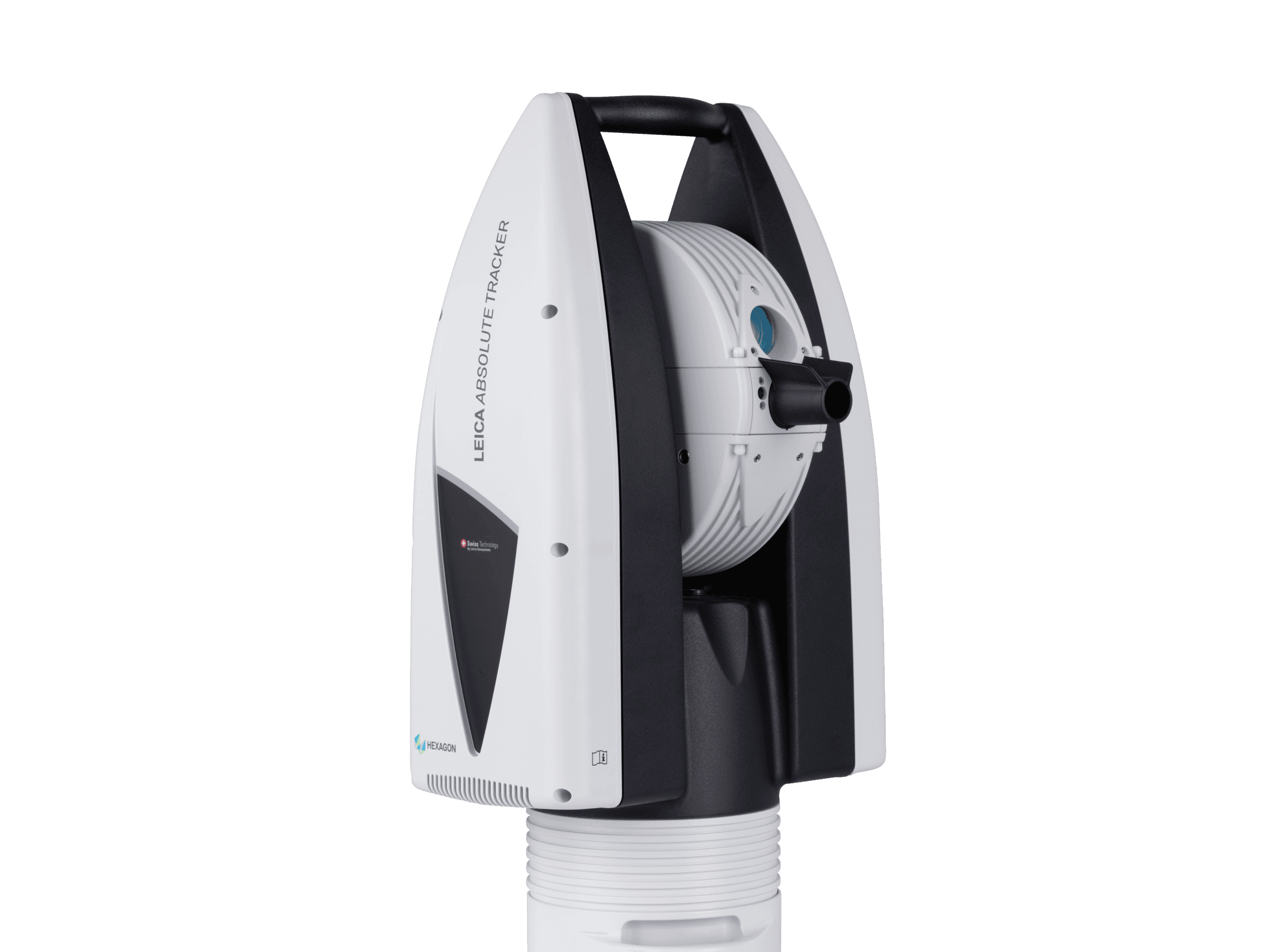

Unrivalled speed, accuracy and portability
High-performance 6DoF laser tracker technology in an ultra-portable and easy-to-use form factor.
The Leica Absolute Tracker AT960 is a robust, all-in-one laser tracker that fits in a single flight case. Offering high-speed dynamic measurement as standard, it is a complete solution for six degrees of freedom (6DoF) probing, scanning and automated inspection as well as reflector measurement.
All-in-one design
With all the equipment for measurement to a reflector, Leica T-Probe, Absolute Scanner or Leica T-Mac built in, the compact all-in-one unit is ultra-portable for easy transportation to measure anywhere
1 kHz data output
Real-time architecture with dynamic performance gives a measurement rate of up to 1 000 points per second, enabling more detailed data capture, more quickly.
Real-time feature pack
Enhance the AT960 with 7DoF data collection to enable the possibilities of real-time machine guidance.
