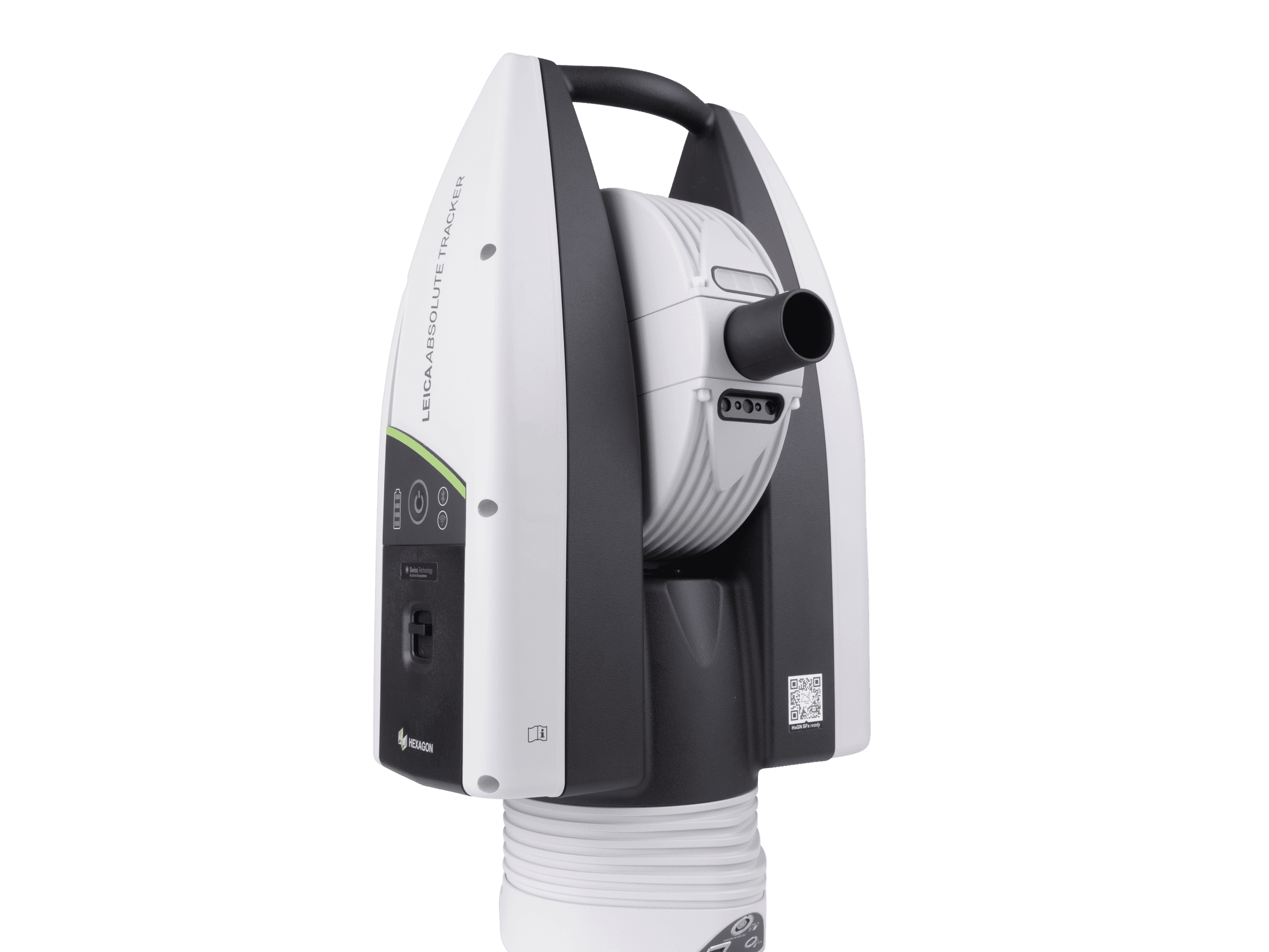

The Leica Absolute Tracker AT500 makes measurement simple without compromising on portability, productivity and resilience. From transport case to large-scale measurement is just a matter of moments thanks to a hassle-free setup process, while IP54-rated protection and an extended operating temperature range keep the AT500 working under even the most challenging conditions. From reflector measurement at up to 160 metres from the tracker to simplified 6DoF probing functionality, the AT500 is ready for every manufacturing and assembly challenge, no matter the size or location.
All-in-one integrated design
From built-in battery-powered controller unit, integrated wireless connectivity, environmental monitoring and all-day battery power, to HD overview camera and ergonomic carry handle, every need is built in.
PowerLock & continuous measurement
Automatically re-establishes interrupted line of sight within a wide field of view with no user interaction required. Continuous time and distance measurement mode, with measurement sampling rate at 100 Hz.
IP54 certification
The IEC-certified sealed unit guarantees ingress protection against dust and other contaminants, enabling effective measurement in even the harshest environments.
Leica Absolute Tracker AT500 Specifications
+/-15 μm + 6 μm/m | |
| Measurement range | |
0.8 to 160 m (3D) 1.6 to 12m (6D) | |
| Measurement mode | |
Stationary, Continuous (Reflector) Stationary (B-ProbePLUS) | |
| Operating temperature | |
-15°C to +50°C | |
| Data output | |
100 Hz | |
IP 54 | |
| Tracker size and weight | |
261 x 239 x 477 mm | 13.6 kg | |
| Certification | |
According to ISO 10360-10 |
