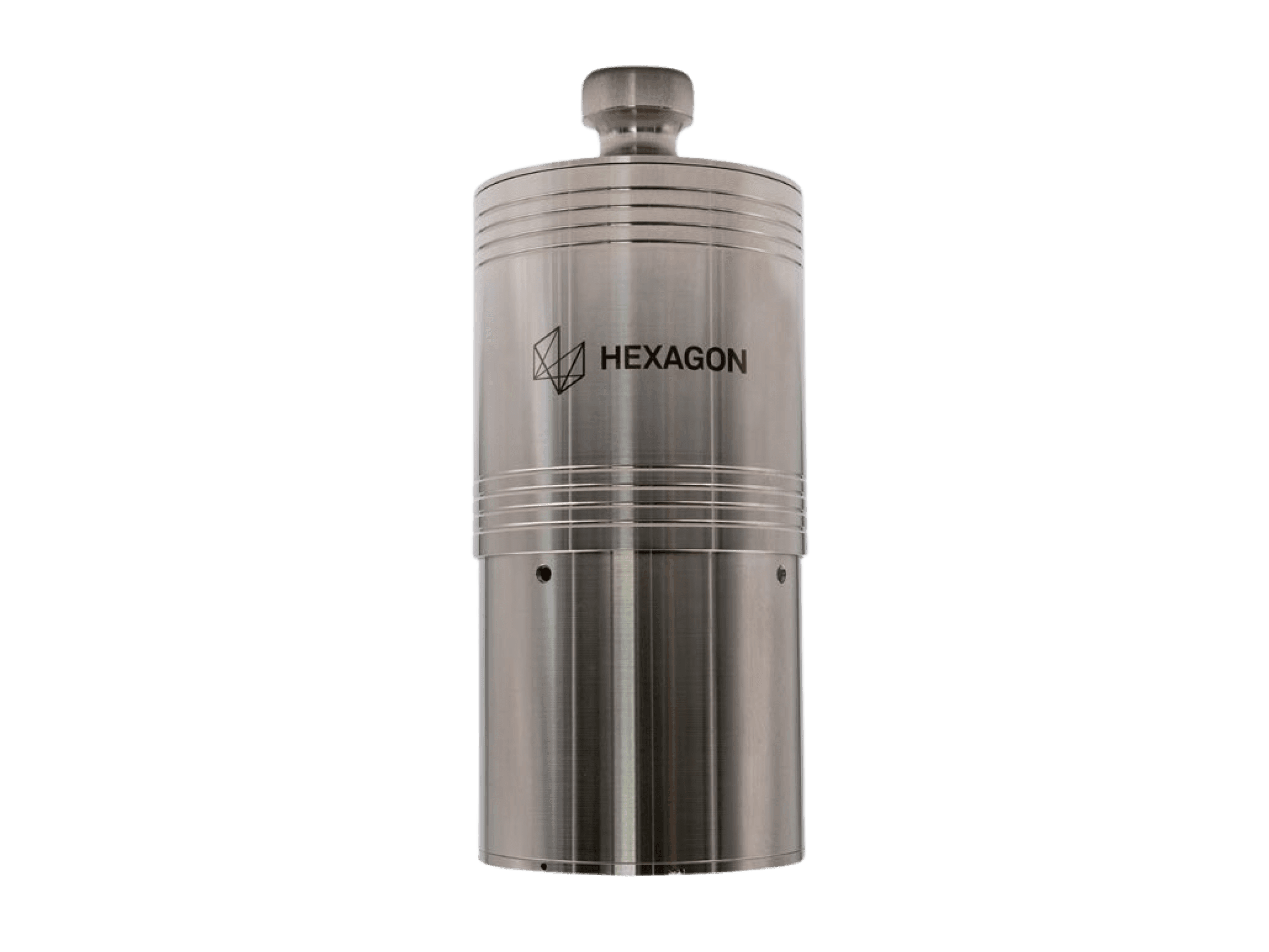

The wireless laser scanner that works automatically with a tool changer
The m&h LS-R-4.8 is a wireless laser scanner for machine tools. Data is transmitted via radio to the machine control and measuring software, which is why the sensor can be changed in and out of the tool changer without any manual steps.
m&h LS-R-4.8 Radio laser scanner Specifications
| Laser class & type | |
Class 2 | PLB450B (laser diode) | |
30 μm(₁) | |
| Working distance | |
115 +/- 40 mm | |
Operation: 5° C – 40°C | |
4x 3.7V battery, 26650, Li-ion, 5000mAh | |
IP68 (IEC 60529) | |
Radio wave |
₁ Depending on the application and installation situation
