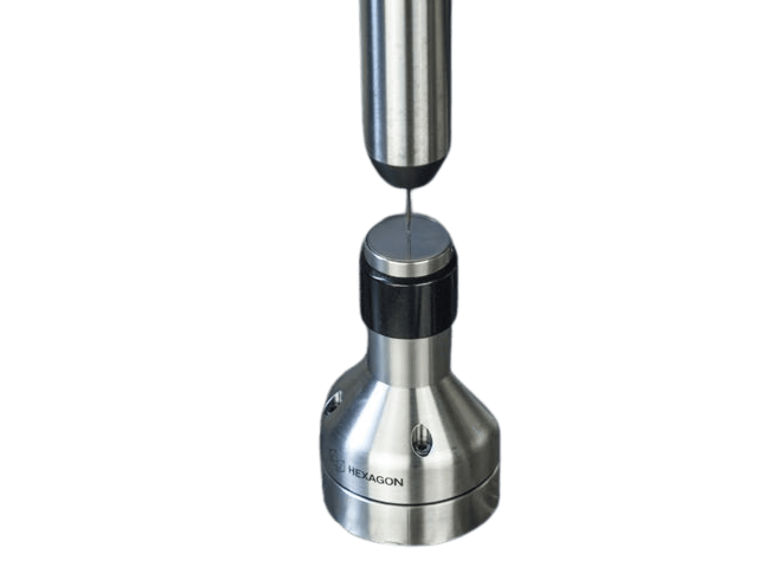

Fast tool breakage control
It is suitable for tool length measurement and tool breakage detection on stationary tools. A particularly low friction linear guide makes it possible to safely measure delicate and very small tools. The fastening to the machine table also permits convenient alignment.
Benefits:
Benefits:
Tactile Cable Tool Setter m&h TS35.30 Specifications
0.5μm (max. 2 Sigma) | |
| Triggering force | |
2,2 N | |
Operation: 10°C -50°C, Storage: 5°C -70°C | |
Battery 12 - 32 VDC, max 25mA with a cable | |
IP68: EN60529 | |
Cable |
