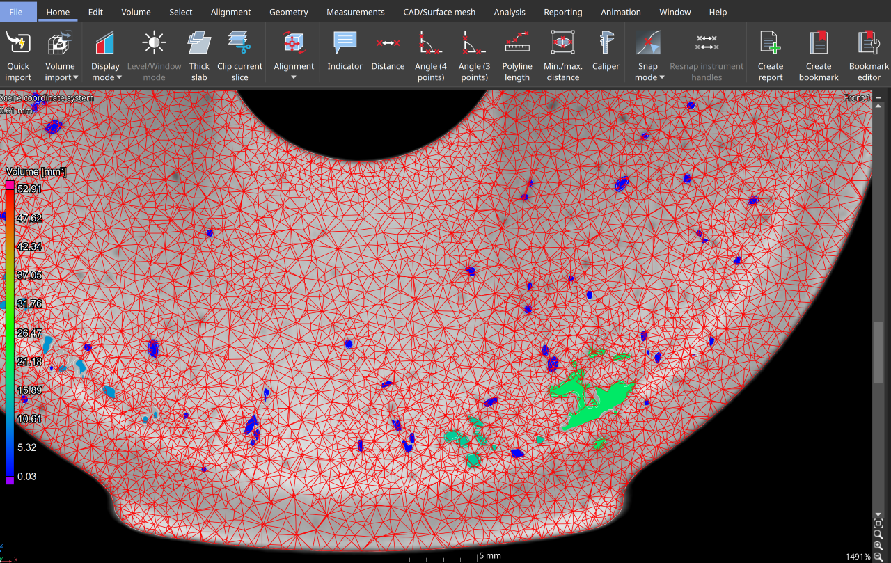

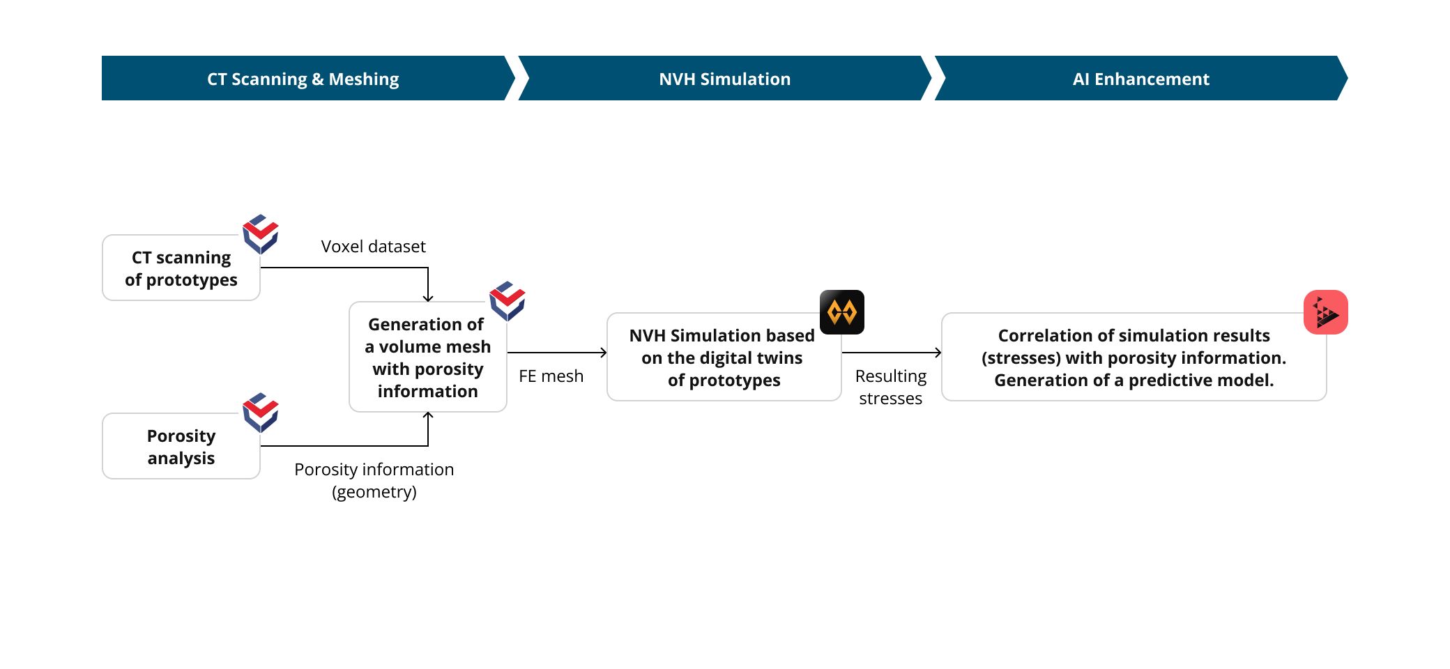

CT Scanning & Meshing
A CT scan is performed to inspect the part and to analyze the porosity in VGSTUDIO MAX. Afterward, a volume mesh is generated based on the CT scan with porosity mapped onto it. By doing so, a digital representation of the manufactured part with all its imperfections is generated.
NVH Simulation
Next, Romax is used to perform an NVH simulation on the digital twin. This procedure can be repeated for multiple prototypes and generates an understanding about the effect of the porosity and the resulting local stiffness variations on the NVH performance.
The simulation results, as well as the porosity information for multiple prototypes, are then fed into Odyssee to create a predictive interpolation model which can be applied to further porosity situations. Based on the outcomes, physically justified and functionally meaningful tolerance limits for porosity can be derived.
