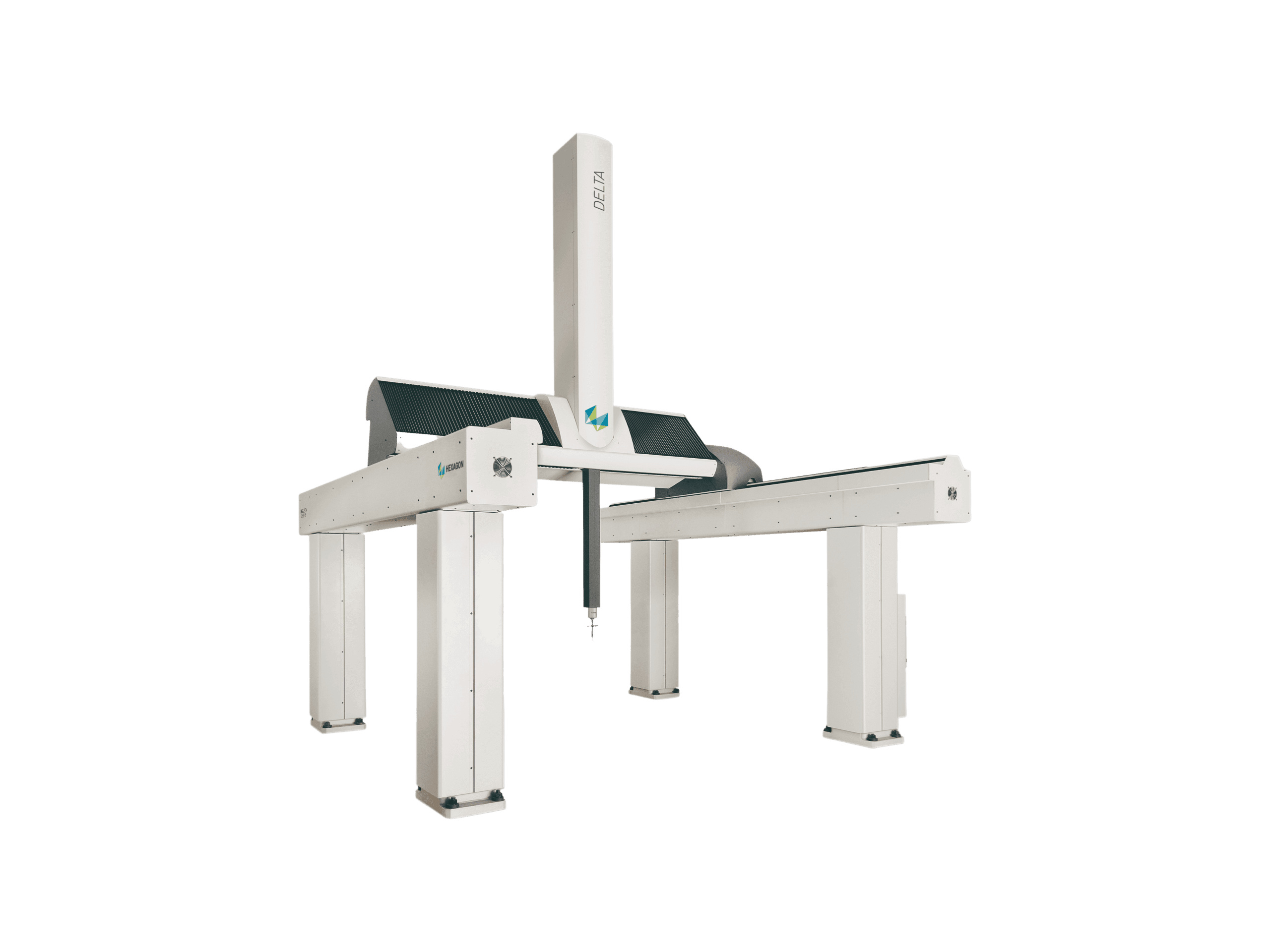

A new performance standard in gantry CMMs
DELTA SLANT is a line of large gantry CMMs that combine high throughput, accuracy, and repeatability with excellent reliability when operating in an open shop environment. Advanced mechanical structure, dual encoder on the main carriage, high-stiffness silicon carbide ram for the Performance version, and high-resolution certified scales are essential features that make this line the ideal system for inspecting and digitizing large precision components.
Two versions are available: DELTA SLANT Classic and DELTA SLANT Performance, with superior dynamic and accuracy performances. Both versions can be equipped with the optional SF-Kit (Shop-Floor). The structural thermal compensation, thermally insulated covers, and forced-air circulation in the machine frame allow operation and high accuracy performance at ambient temperatures varying between 16 and 26 °C.
