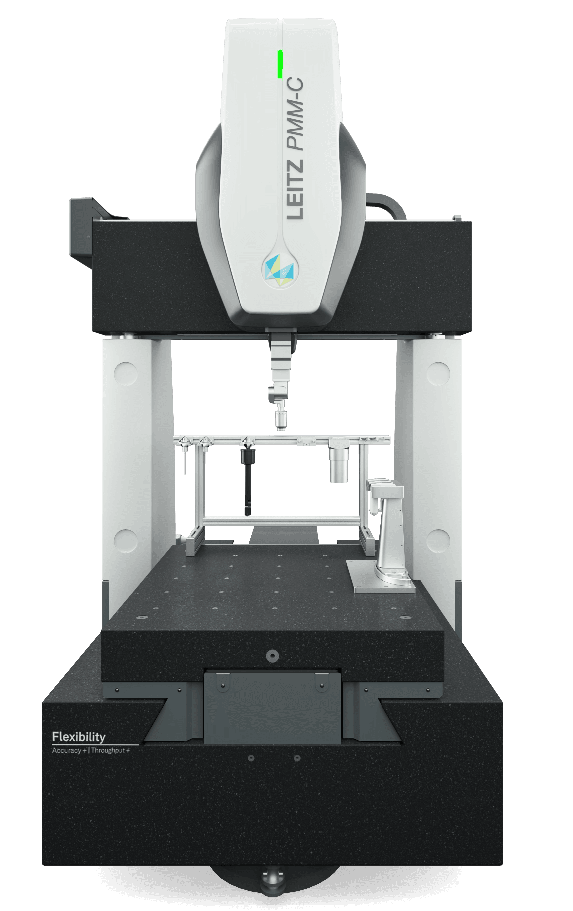

Leitz PMM-C CMMs are highly precise, premium metrology devices that deliver fast, ultra-high accuracy results to fulfil the most demanding inspection requirements across a range of precision applications.
The latest generation of machines offers exceptional accuracy across the series, with specific configurations and capabilities to serve individual application needs.
The Leitz PMM-C Flexibility model is configured to boost the machine’s adaptability to more challenging applications and part features and decrease cycle time. It combines accuracy and flexibility in one measurement solution.
This model has an articulating probe head that measures at any angle to improve access to complex 3D part geometries. In addition, the SENMATION sensor automation system increases measurement flexibility by allowing the seamless integration of a variety of tactile and optical sensors within one measurement routine to address multi-part or multifeatured applications.
