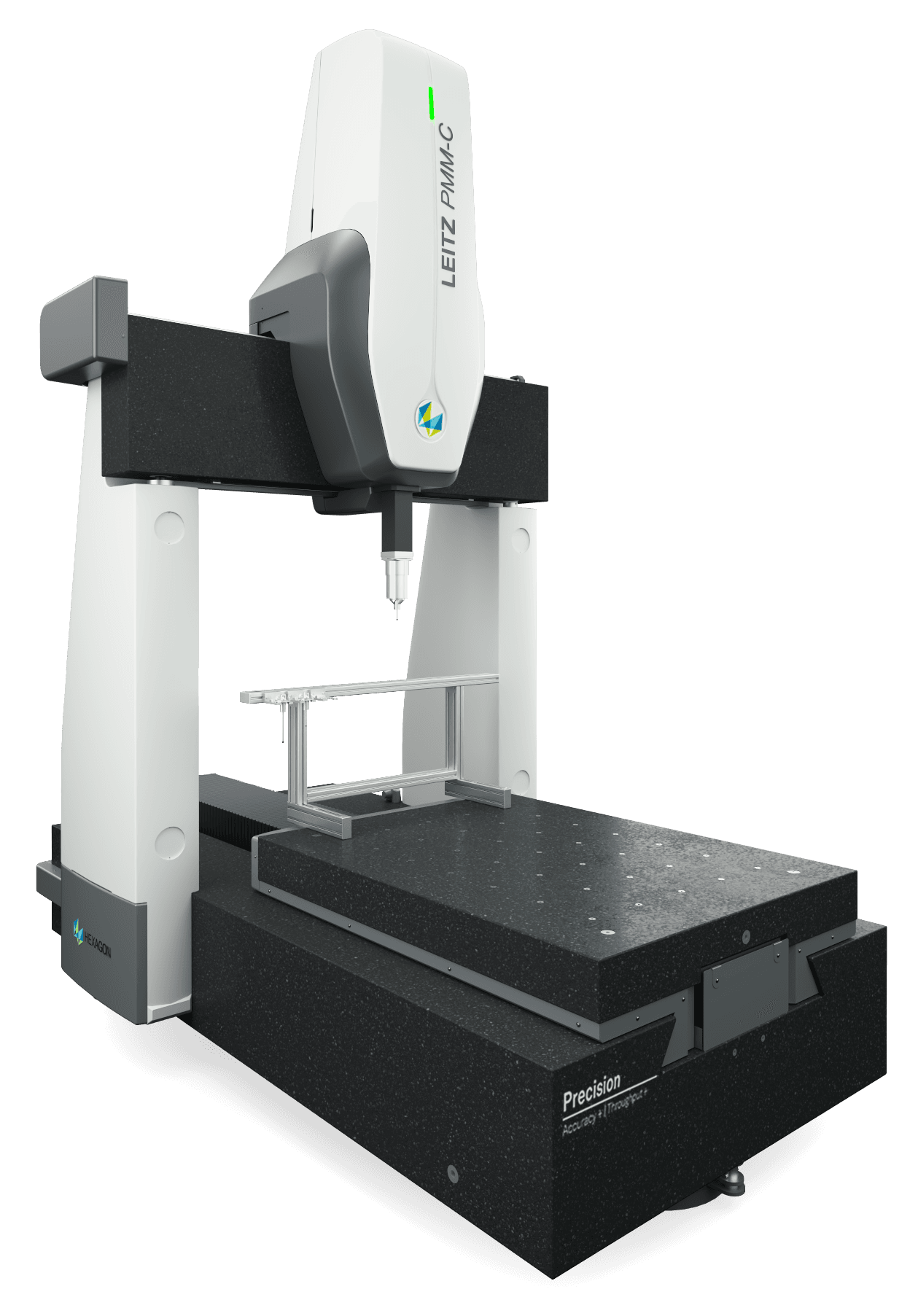

Leitz PMM-C CMMs are highly precise, premium metrology devices that deliver fast, ultra-high accuracy results to fulfil the most demanding inspection requirements across a range of precision applications.
The latest generation of machines offers exceptional accuracy across the series, with specific configurations and capabilities to serve individual application needs.
The Leitz PMM-C Precision model is configured to achieve the best possible measurement capability using ultra-high precision fixed probe head measurements. This model offers maximum repeatability and form measurement accuracy, even for long or multi-styli configurations in fast single-point probing or variable high-speed scanning procedures.

Leitz PMM-C Precision Specifications
07.07.05 / 10.07.06 / 12.10.07 / 16.12.10 / 24.12.10 / 24.16.10 | |
| Accuracy₂ | |
From 0.28μm + L/1000, MPE(E0)₃) [19-21 °C] From 0.7μm + L/400, MPE(E0/E150)₄) [18-24 °C] | |
Scanning probe Non-contact probe (optical sensor) Contact probe (roughness sensor) Laser scanner probe | |
18-22 °C (standard temperature range) 19-21 °C (Accuracy + model) 15-30 °C (XT, option) |
