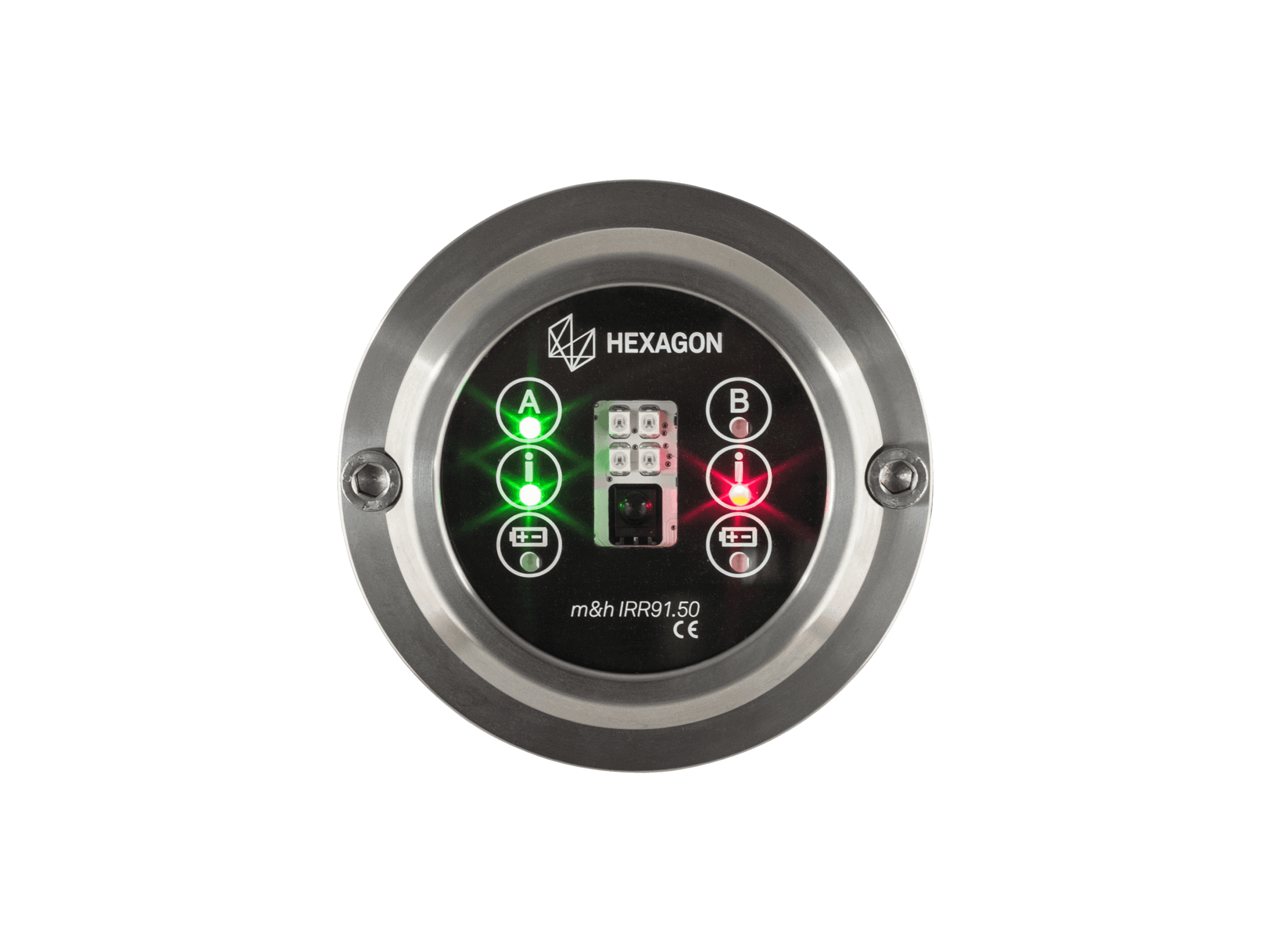

Infrared receiver with dual-probe as well as bidirectional HDR+ technology
The bidirectional infrared receiver IRR91.50 is able to simultaneously communicate with two probing systems on the same machine. It has large transmission and receiving angles and can be used for all m&h infrared probes and tool setters. All necessary components are integrated in the stainless steel casing; thus, no additional interface in the electric cabinet is required.
Infrared Receiver m&h IRR91.50 Specifications
Operation: 10° - 50°C Storage: 5° - 70°C | |
12 - 23 VDC, max. 100 mA | |
IP68: EN60529, IEC529/DIN40050 | |
Infrared |
