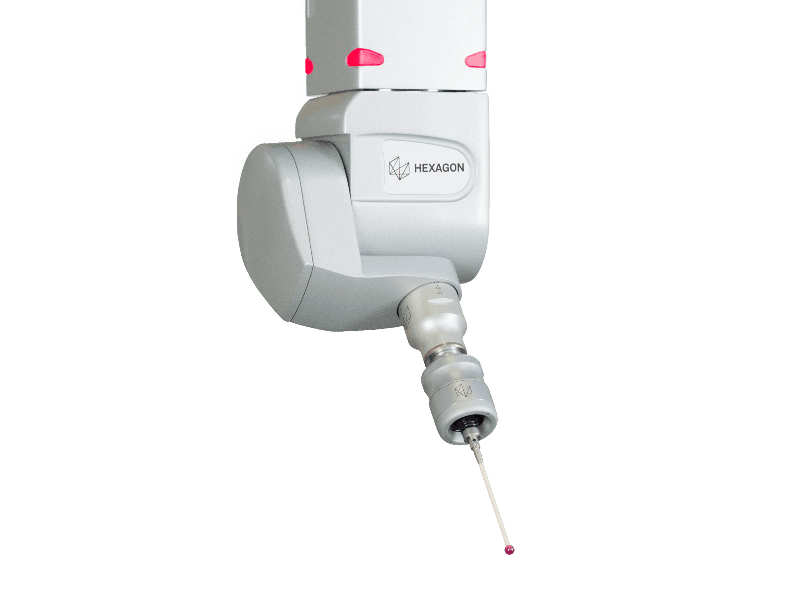

A new degree of freedom
The HH-A-T2.5 is capable of indexing in 2.5° increments and can achieve 12,240 unique positions. The head is fitted with a kinematic joint (TKJ) which can be connected to a Multiwire to give multi-sensor support.
The HH-A-2.5 range of probe heads feature a number of new innovations including an fully embedded controller, capacitive crash protection and the all new heavy duty kinematic joint.
HH-A-T2.5 / HH-AS-T2.5 Automatic 2.5° Probe Heads Specifications
| Indexing angle | |
2.5° | |
| A-axis angle | |
+/-105° | |
| B-axis angle | |
+/-180° | |
| Total number of positions | |
12 240 | |
| Rotation speed | |
90° in 2.5 sec. | |
| Max. extension length | |
450 mm | |
| Probe mounting | |
TKJ | |
| Changer rack compatibility | |
YES |
