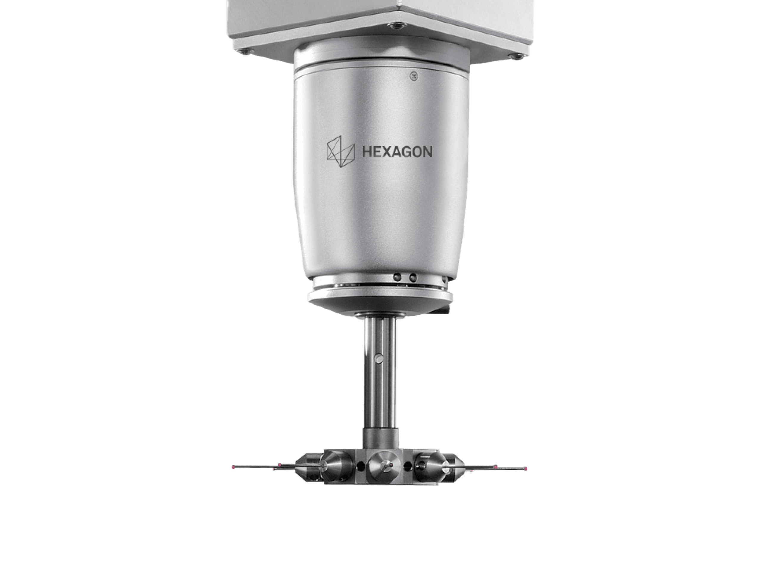

High-speed scanning probes
The HP-S-X3 offers fast single-point probing for all standard measuring tasks and High-Speed-Scanning for form and profile inspection and is ideally suited for dimensional control of small to medium high-accuracy prismatic parts and complex geometries.
An automatic tool-changing capability allows styli change within a measuring program without needing probe requalification. Magnetic clamping of styli on the sensor permits fast and reliable changes.
HP-S-X3 Scanning Probes Specifications
| Probe type | |
Analogue | |
| Probe mounting | |
TKJ (kinematic joint) | |
| Stylus holder thread | |
M5 | |
| Max. stylus length | |
Up to 360 mm | |
| Max. stylus weight | |
150g (incl. stylus clamping) | |
| Measurement range | |
+/- 1mm in all axes | |
| Resolution | |
< 0.1 μm | |
| Linear stiffness | |
6 N/mm |
