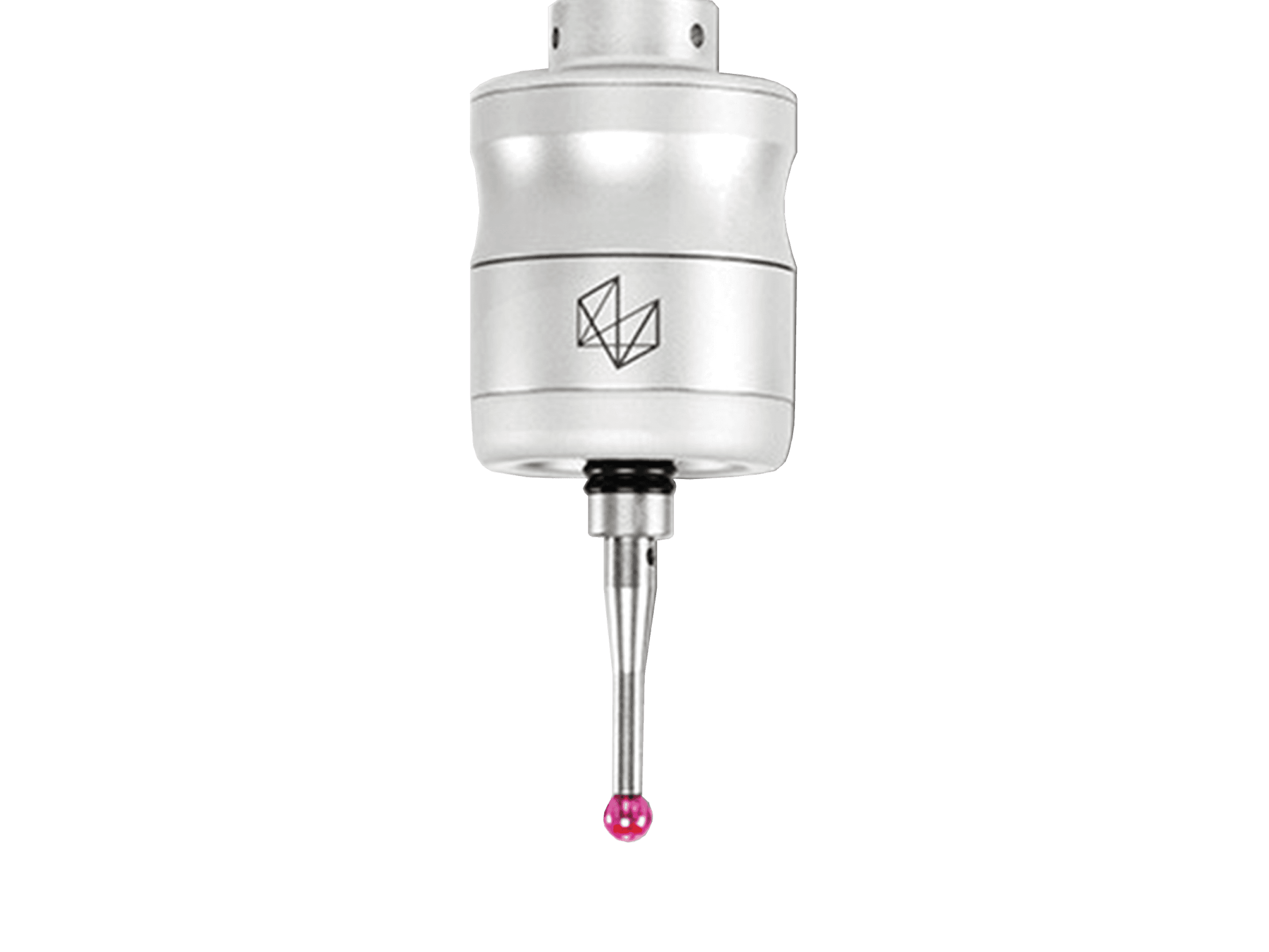

The rugged touch trigger probe for harsh environments
The HP-T-RP is a rugged and accurate touch trigger probe that can be mounted on many coordinate measuring systems such as bridge, gantry, horizontal arms, manual or CNC, portable devices, and even robots.
This sensor can operate in any industrial environment, even in the most hostile. Optimized accuracy is ensured through an adjustable trigger force according to the chosen stylus configuration.
HP-T-RP Probe Specifications
| Mounting | |
M8 | |
| Probing direction | |
5 ways +/-X, +/-Y, +Z | |
| Stylus mounting | |
M3 thread | |
| Max. stylus length | |
100 mm | |
| Trigger force | |
0.11 N to 0.30 N | |
| Pre-travel variance | |
Not available | |
| Repeatability (1D, 2sigma) | |
0.35 μm |
