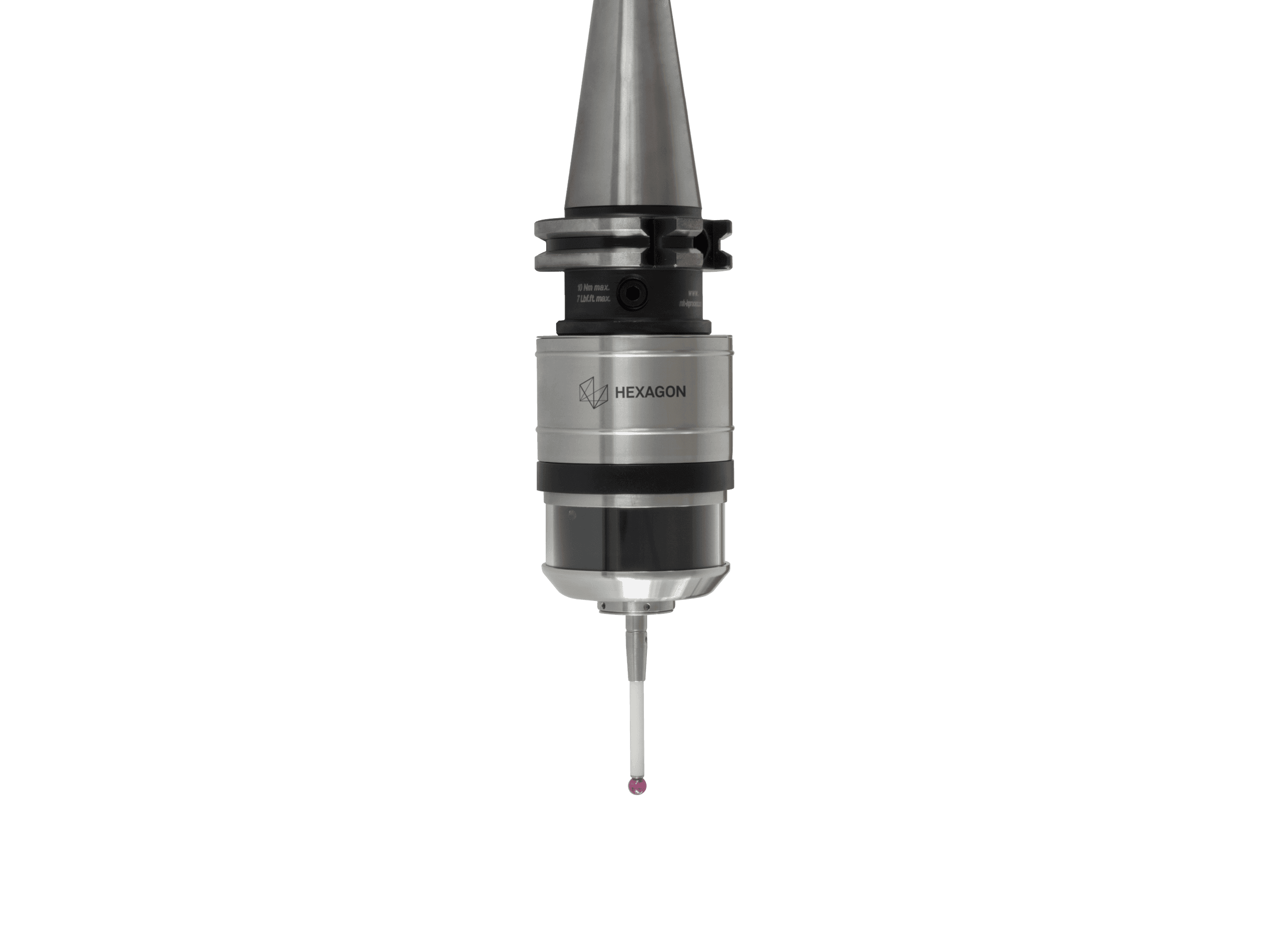

Radio-wave touch probes of the newest generation
m&h RWP20.50 radio-wave touch probes are available in two different frequency ranges. As a technology pioneer, m&h long ago introduced the first reliably functioning probe with radio-wave transmission of the measurement signals onto the market. The industrial frequency band of 433 MHz is still used today for reliable transmission of time-critical signals. The new radio-wave touch probe is still compatible with existing equipment in the available 433 MHz version. Alternatively to this, the new m&h RWP20.50 radio-wave touch probe is also available with a new radio transmission technology in the frequency range of 2.4 - 2.4835 GHz.
Radio-wave Touch Probe m&h RWP20.50 Specifications
Max. 1μm (2 Sigma) with 50 mm Stylus at 254 mm/min | |
| Triggering force | |
PP41.00 – XY = 0,3 - 1,4 N; Z = 2,5 - 12,5 N MY21.00 – XY = 1 N; Z = 6 N | |
Operation: 10°- 50°C Storage: 5°- 70°C | |
1 x 9 V battery block, 6LR61 Lithium: 1200 mAh, Alkaline: 550 mAh | |
IP68: EN60529 | |
Radio-wave |
