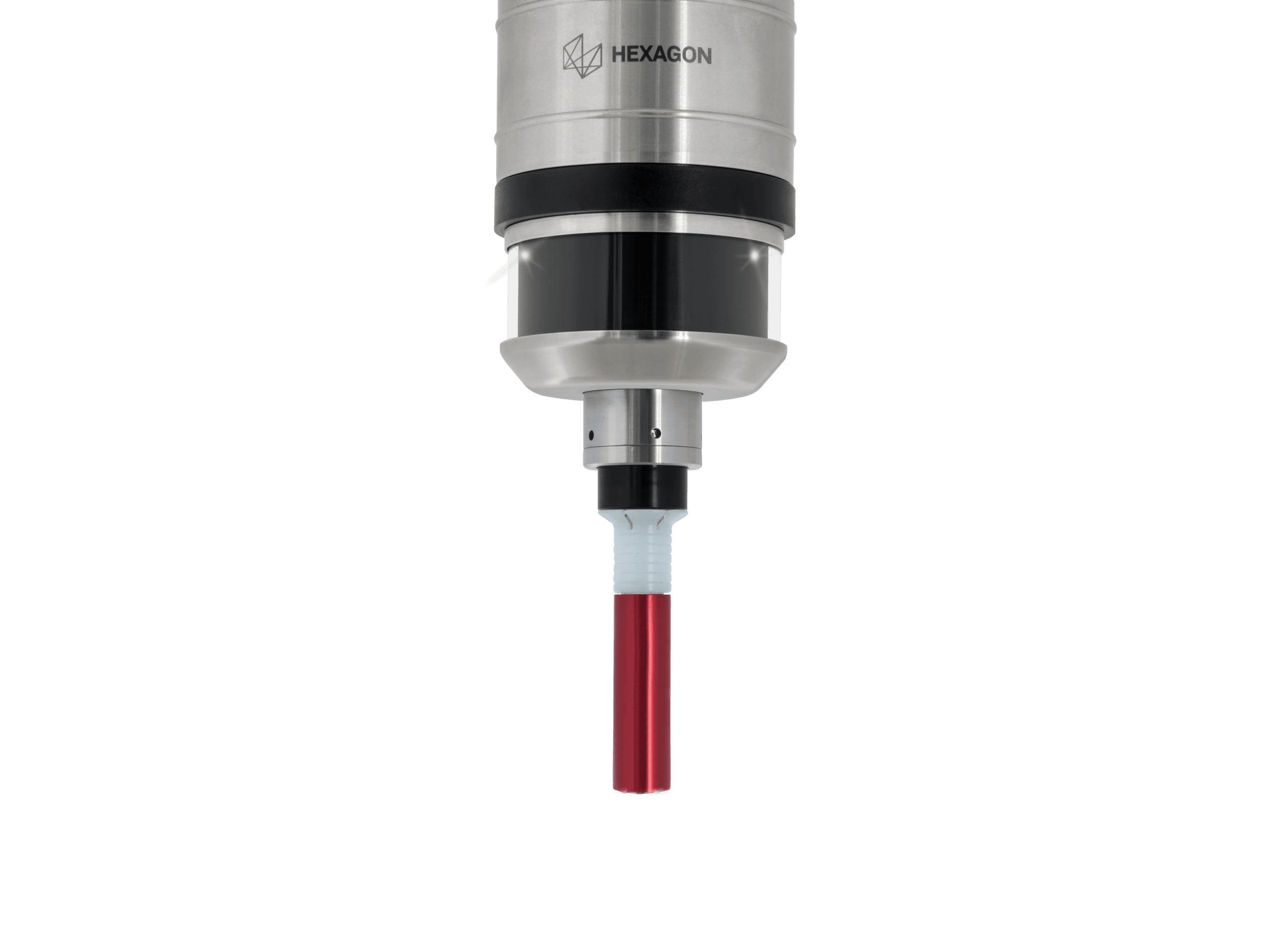

The m&h RWP20.50-TP temperature probe measures part temperature in seconds, both before and during machining. The m&h RWP20.50 drives high production quality by ensuring that workpieces are only machined within the defined temperature parameters. Detecting longer wavelengths than infrared, the radio wave probe is ideal for use on large machining centers and 5-axis machines.
m&h RWP20.50 probes are characterized by high measurement reliability, using the microprocessor-controlled receiver's SCS (Self-Channel-Select) technology to continuously check surroundings and block any interfering signals from other radio wave sources. MDR (Multi Data Rate) technology in the 2.4 GHz range offers fast transmission of high data rates and large data sets.

Radio Temperature Probe m&h RWP20.50-TP Specifications
±1°C₁ | |
| Measuring range and resolution | |
13 N (Trigger force with 50mm sensor) | |
Storage: 5 °C – 70 °C, Operation: 10 °C – 50 °C | |
1 x 9 V battery block, 6LR61 Lithium: 1200 mAh, Alkaline: 550 mAh | |
IP68: EN60529 | |
Radio-wave |
₁ The measuring accuracy depends on the condition (surface finish, surface parallelism) and calibration of the workpiece.
