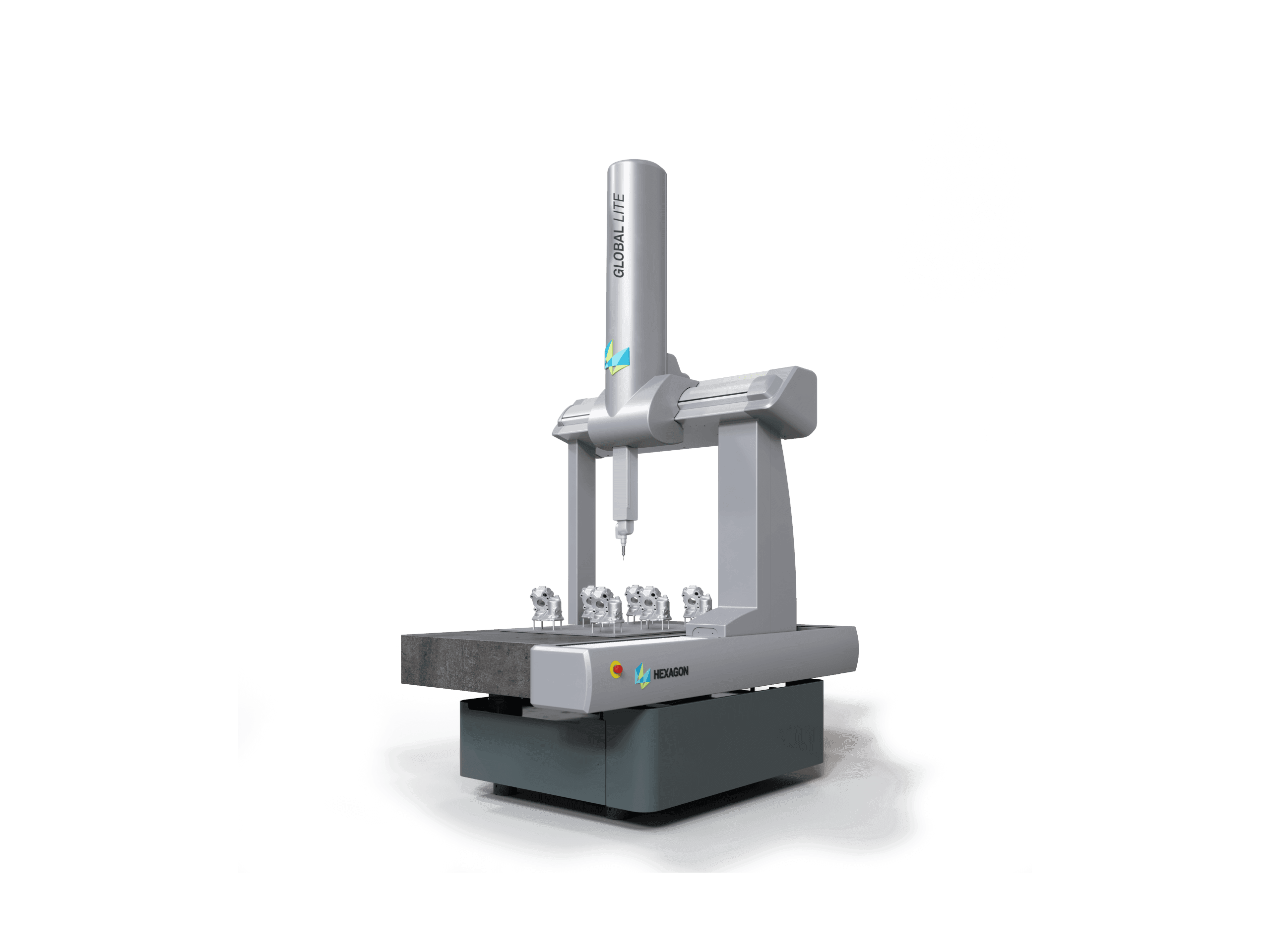

GLOBAL Lite Specifications
| Available size (X, Y, Z) | |
07.07.05 / 07.10.07 / 09.12.08 / 09.15.08 / 09.20.08 / 12.15.10 / 12.12.10 / 12.30.10 | |
| Accuracy₁ | |
From 1.9μm + L/300, MPE(E0/E150)₂) [18-22 °C] From 2.2μm + L/250, MPE(E0/E150)₂) [16-26 °C] | |
Touch-trigger probe | |
18-22 °C (lab temperature) 16-26 °C (extended temperature, option) |
₁ According to ISO 10360-2 (2009)
₂ MPE(E0/E150) specifications are to be formally understood as MPE(E0E150)* for the case where non-normal CTE material calibrated test lengths are used. Length unit measure (L) in mm
