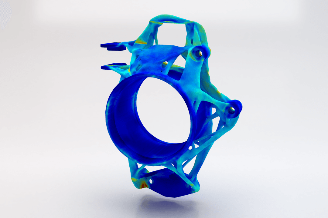

Stress-based optimisation for robust part designs.

Experience the future of product development with MSC Apex Generative Design, where stress-based optimisation and automatic mesh-to-CAD retransition streamline your workflow. This software ensures optimal structural integrity and material efficiency. It rapidly generates design candidates and enables an efficient design process.

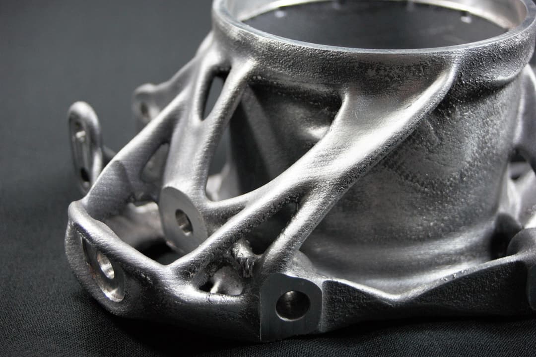

Tailored for AM: Fast track to innovation
Redefining additive manufacturing, this highly automated design process crafts bionic shapes tailored specifically for AM. By minimising support structures and optimising material use, it ensures that parts are manufacturing-ready, enhancing efficiency and reducing waste.
